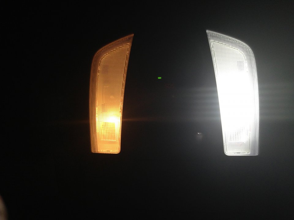

    I ordered an 8 LED Interior kit off of eBay for 22, including shipping. I was a little suspect everything would fit as expected and I only had one real issue and a few small ones:
    • The map lights use a 18 SMD Led panel. They don't fit flat against the backside of the light housing but they do have a few sticking points which should keep it secure
    • I was going to use the door lights for the license plate, but they are too long and did not fit. For the door lights, they BARELY fit. Be sure to align the front facing square led in the round hole
    • The only main issue is that they supply an 18 SMD LED for the trunk light and it doesn't fit. Looks like I have to get a few lights from superbrightleds to finish the project.
    As you would expect, everything is now super bright white and not yellow. To be honest, I'm not sure if I like it or not! It's really bright and a little "shocking" compared to the original yellowish incandescent lights. I'm going to see if it grows on me.
    IMG_3716.JPG Map light example of before and after.

    Daylight colored lighting looks very modern to me. I prefer that color.

    Was the fitment issues because of the circuit board causing issues? Could it be filed or trimmed to fit?

    I actually did file the edges of the ceramic and got it to fit lengthwise, however there is a little jut in the plastic that made it overhang off about 1/4 inch. I would had to dremel it out and I decided that it wasn't worth it since I had to order a few other leds from superblahblah anyway.
    Im waiting for license plate leds, trunk, center console (have to wire it), illuminated sill plates and LED fog lights.
