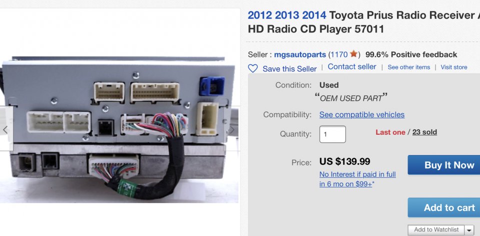

    You mean this part right? Is it really that simple?​

    Yes. The bottom ‘slice’ being the Harmon extension box. Be sure any replacement includes harnesses, or connectors and pigtails, just in case. Go for the latest build date available. 2014 is probably the latest for a 57011.
