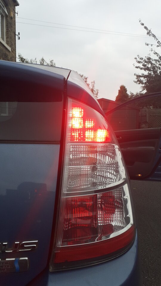

    The led brake light went fully out pretty much on the offside. I disconnected and reconnected it and it was good again. Next day it's almost fully out again. Anyone had this problem and fixed it without replacing the whole unit. Anyone bought the AliExpress ones and had success. Mines the black variant.

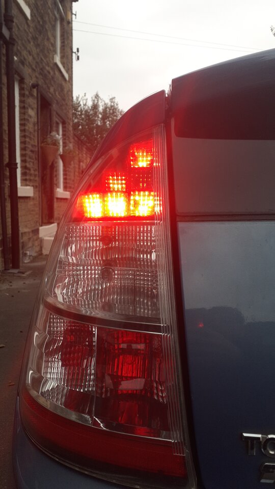

  3. james909
    james909 Member
    Aug 10, 2015
    107
    Leeds, U.K
    It came with LEDs. Shown working here but now the offside is not working. IMG-20251018-WA0006.jpeg

    Not on Gen 2. Gen 2 shipped with a LED cluster.
  7. ChapmanF
    28,698
    19,001
    In gen 2, the taillight, side marker, turn signal/hazard, and back-up lights are replaceable bulbs. The stop, or brake, lights are LEDs built into the housing.
    They give that neat effect you can see in the photo in #3, where when the brake lights are off, that part of the combo light appears to match the dark glass across the hatch. The plastic lens isn't tinted or darkened at all, so the brake lights don't lose any brightness, but when they're off you're seeing the black surfaces below the reflectors.
    Then with the refresh in (2006, I think?) they gave up on that effect and made those surfaces silver instead of black.
