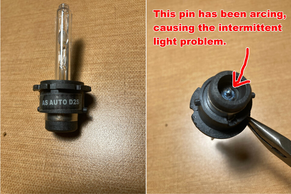

  3. steve0826
    steve0826 Junior Member
    Feb 27, 2008
    30
    Bellevue, WA
    Correct, it is not the relay. The problem is the HID lightbulb. See picture.
