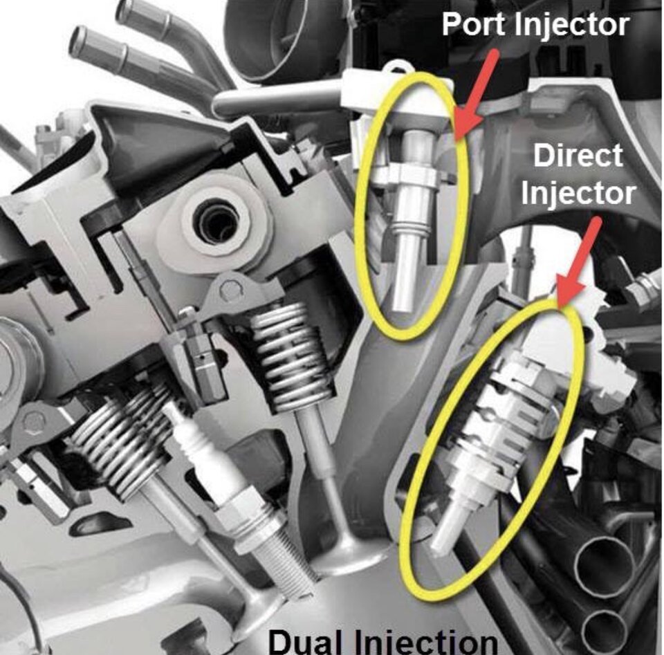

    In more recent engines with exclusively Direct Injectors pumping gas straight into the cylinder, no additive can do anything to the back of the valve. As a result Toyota now uses dual injection in the latest gen5 Prius and the last two Rav4 generations to name two.

    All gasoline has additives to clean fuel injectors and it works as designed. In a good engine with port injection, it will keep the back of valves acceptably clean.
    If you want a cleaner gen3 engine, mechanically repair oil burning when present and then change oil every 5k.
    or better yet
    Buy a Toyota with a dual injection engine.
