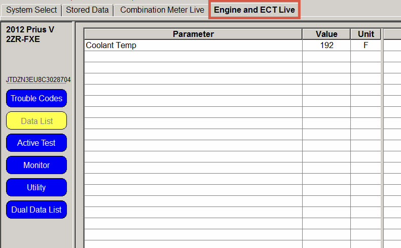

    According to a search, a 2020 Toyota Corolla Hybrid has an Exhaust Heat exchange (EHex) system which helps some of the coolant to quickly warm up the throttle body before the thermostat opens.
    A coolant-temperature sensor downstream of the EHex system will read hotter temperatures before a second coolant temp sensor monitoring the engine and the large return radiator hose warms up.
    If the thermostat is stuck open when the engine is cold, full flow into the radiator will slow engine warmup. Normally it takes 5 minutes or less for the engine to warm up since most flow is initially blocked by the thermostat.
    You probably have a bad thermostat.
    The diagram below is a similar dual passage cooling system of a 4th gen Prius. Remember flow into the thermostat's bypass inlet is not blocked by the thermostat but radiator flow will be when cold.
    Techstream and most scanners label both sensors "coolant temp/temperature." Each is read by a separate ecu; typically the Engine ecu for the Head mounted sensor and the Combination Meter ecu for the Exhaust Heat exhanger sensor.
