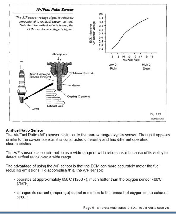

  5. Patrick Wong
    Patrick Wong DIY Enthusiast
    Mar 8, 2008
    18,210
    6,526
    Green Valley, AZ
    Yes, I understand that.
    As the engine ECU varies the air/fuel mixture, it compares the voltage output provided by the upstream air/fuel ratio sensor, with the voltage output provided by the downstream oxygen sensor. The engine ECU expects the upstream sensor voltage output to vary widely while the downstream sensor voltage output should be fairly constant which proves the catalytic converter is functioning correctly in converting HC to CO2 and H2O.
    If the upstream sensor is marginal then its voltage readings will not vary as widely as a new sensor. Hence the installation of a new sensor may help the engine ECU to decide the catalytic converter is acceptable.
    Especially since the OP has pointed out that the issue is intermittent, that provides further hope that replacing the air/fuel ratio sensor may allow the OP to defer replacement of the catalytic converter.
    ydpplqbd, SFO and koolingit like this.
  6. Drdiesel
    Drdiesel Active Member
    Jun 11, 2013
    585
    153
    Monterey CA
    Not quite! An A/F sensor doesn't have the same signal as an Ho2s.
    The post sensor input is the determining factor for P0420.
    SFO likes this.
