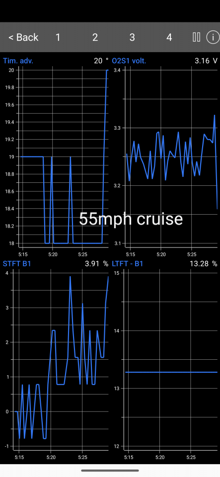

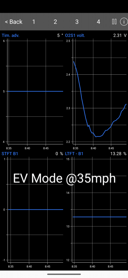

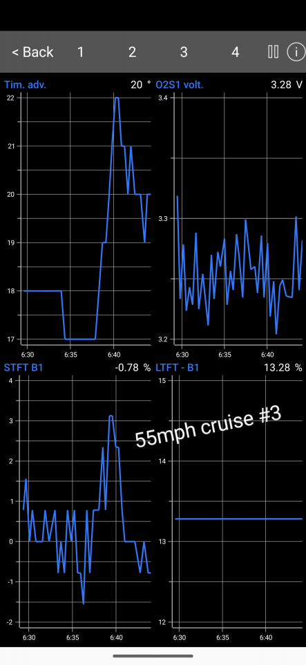

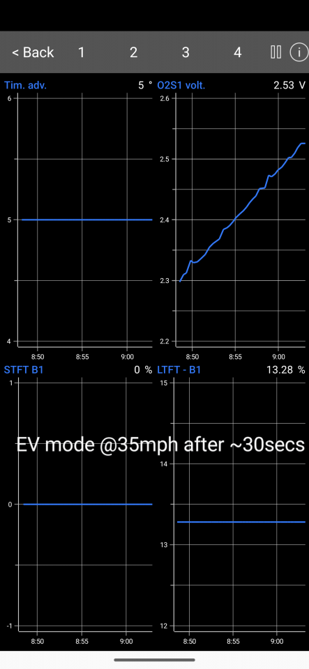

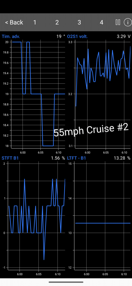

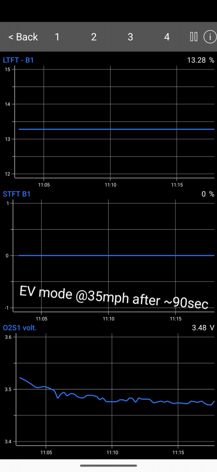

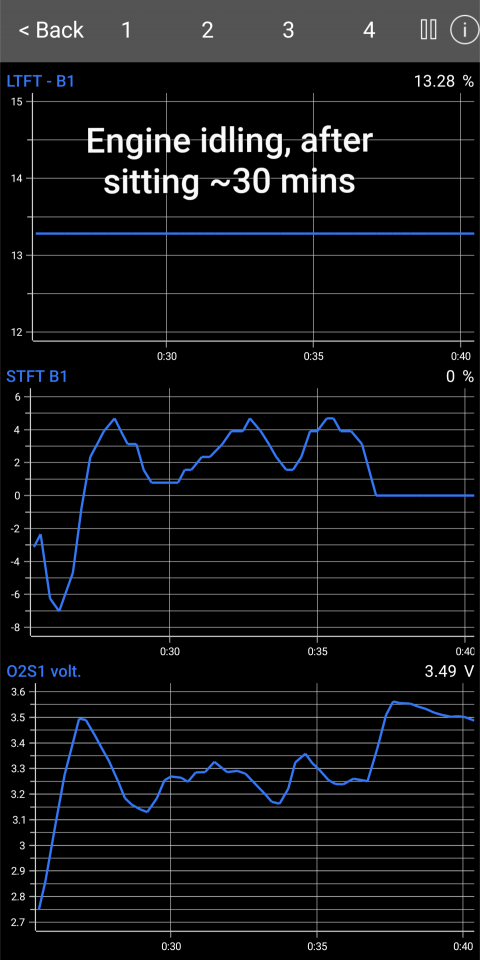

    What do you see for Long Term and Short Term Fuel Trim data while the ICE is running - warmed up? Ideally, both should stay fairly close to 0 +/- 10%. Check at idle, fast idle, and steady throttle cruise.
    Rattle on cold start is usually the VVT actuator (intake cam sprocket) not locking - then it smacks back & forth until the engine & VVT build oil pressure. A stuck VVT solenoid will set codes and sometimes cause rough idle or idle stall (because cam timing isn't where the ECM expects).

    Here are some screenshots I was able to grab while I was out earlier. These were all taken w/ the car up to temp. Was only able to get one screenshot w/ the car idling without adding throttle input because even with the heater cranked to max it's still too warm to get it to keep the ICE on 100% of the time (and I couldn't remember the pedal dance for maintenance mode at the time)
    As for the VVT knocking sound, putting the solenoid through the ultrasonic cleaner seems to have fixed or at least greatly reduced it from what it was. Cold start/idle is way smoother, ICE engagement seems smoother, engine start seems more immediate, etc

    However P0171 and P2195 still seem to return at random. MAF and throttle body have been very thoroughly cleaned, intake was cleaned, new air filter, cleaned the PCV valve, etc. If it's not the MAF, which i don't think it is considering i super cleaned it and my P3190 hasn't returned, I'm not sure what else could be causing it. Vacuum line to the PCV looks fine, no obvious cracks in the intake boot, idle quality seems fine (which is where i think a vacuum leak would be most noticeable if that is what it is). Upstream O2 sensor data is in the post above this one, but at this point it's either got to be that or a failing fuel pump right?
