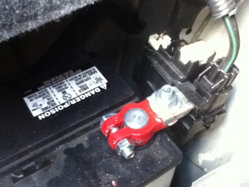

    Here's the conversion setup for the battery.. There wasn't any resistance in the terminals or negative to ground connection.

    If only an 8 amp load causes the voltage to sag to 11.6 I'd say the battery is toast. Even though it's young, it may be defective. Hopefully it's still under some kind of warranty. Have it load tested at your FLAPS.
    Hard to tell from photo but it might be some kind of custom setup. (i.e. not a "dealer battery")
