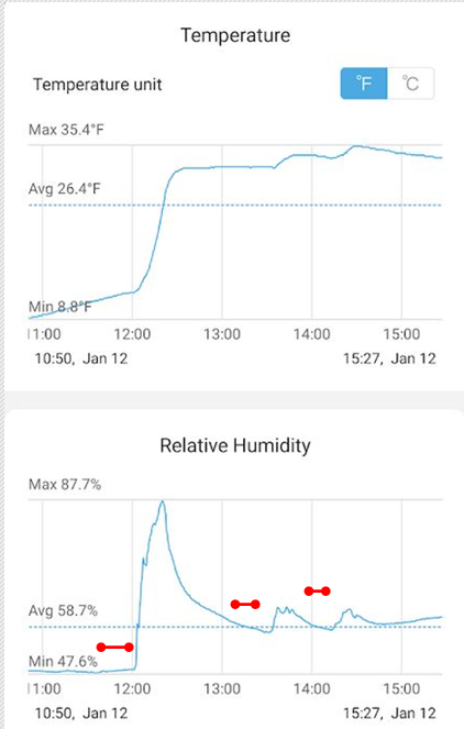

    First, I keep a thermometer/hygrometer on my dash to monitor cabin temp and humidity. When relative humidity is low, there is no worry about fogging up the window. I try to keep the cabin humidity below 70% all the time. For three short trips yesterday, while I was driving (indicated by the red lines in the graph below), the cabin humidity was lower than 60%. Humidity rise takes time (see the lag on the rise after my drive) and with a short trip of less than half-hour with only one passenger, inside window fogging is not a problem.
