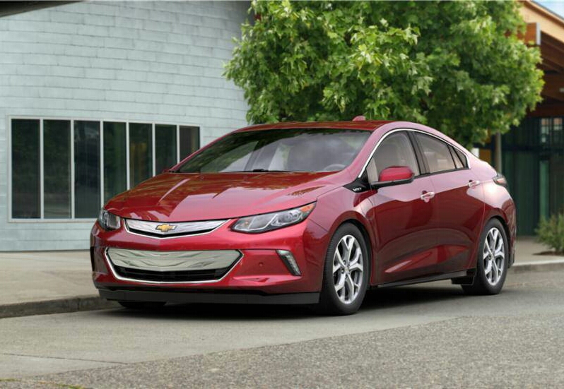

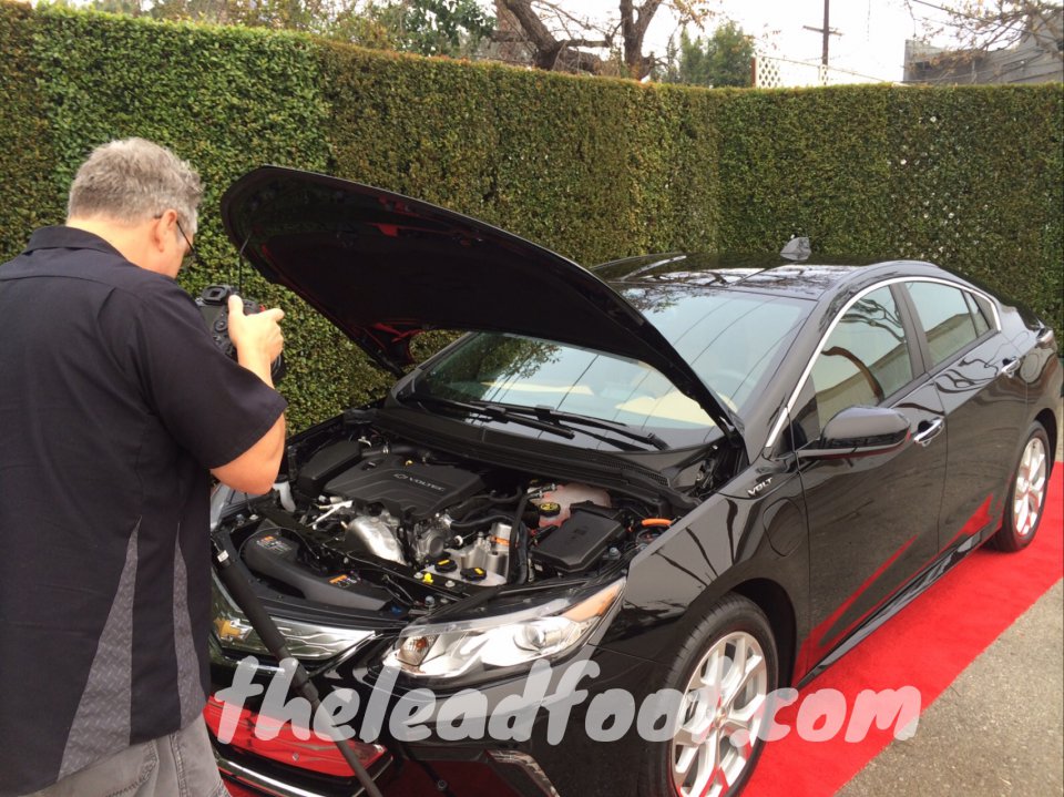

    I actually like it A LOT more in red. Black looks nice too. I think it's the blue color that makes me think, meh.
