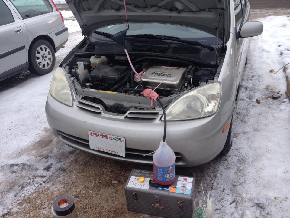

    I picked up a flexible funnel and some tubing. If I can do it without making a mess I hope to use the tubing to route the old coolant coming back to the reservoir into a container and have the pump pull fresh coolant into the loop. I thought it would give me a better idea of the flow rate and how nasty the coolant is.

    I rigged up a funnel and hose so I could pour fresh TSLLC into the intake and divert the old stuff into a container. Obviously not as thorough as a drain-flush-refill, but since the old and new coolant didn't mix in the reservoir and I ran a gallon through (capacity is 3 qts) I think it was effective. And I didn't have for worry about bleeding air out afterwards. The old coolant was a dark color, and perhaps a bit thicker than the fresh, but nothing like the slime I was dreading.
    Anyway, the pump did seem to pep up a bit. I should have timed it, but I'd guess it took 2 minutes to run a gallon through. Meaning (very approximately) .5 gpm, which seems low to me but I couldn't find specs on what the should be. I have EngineLink, so I'll just keep an eye on the inverter temps. Unless I see a drop in performance, I'll wait till spring to replace the pump.
