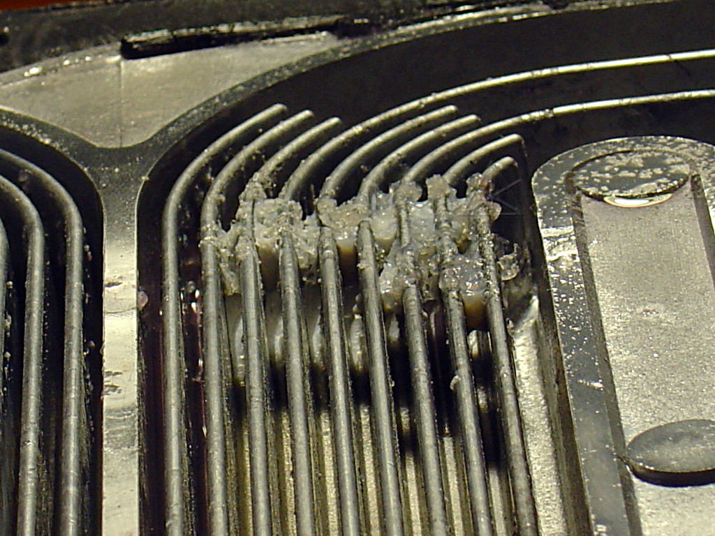

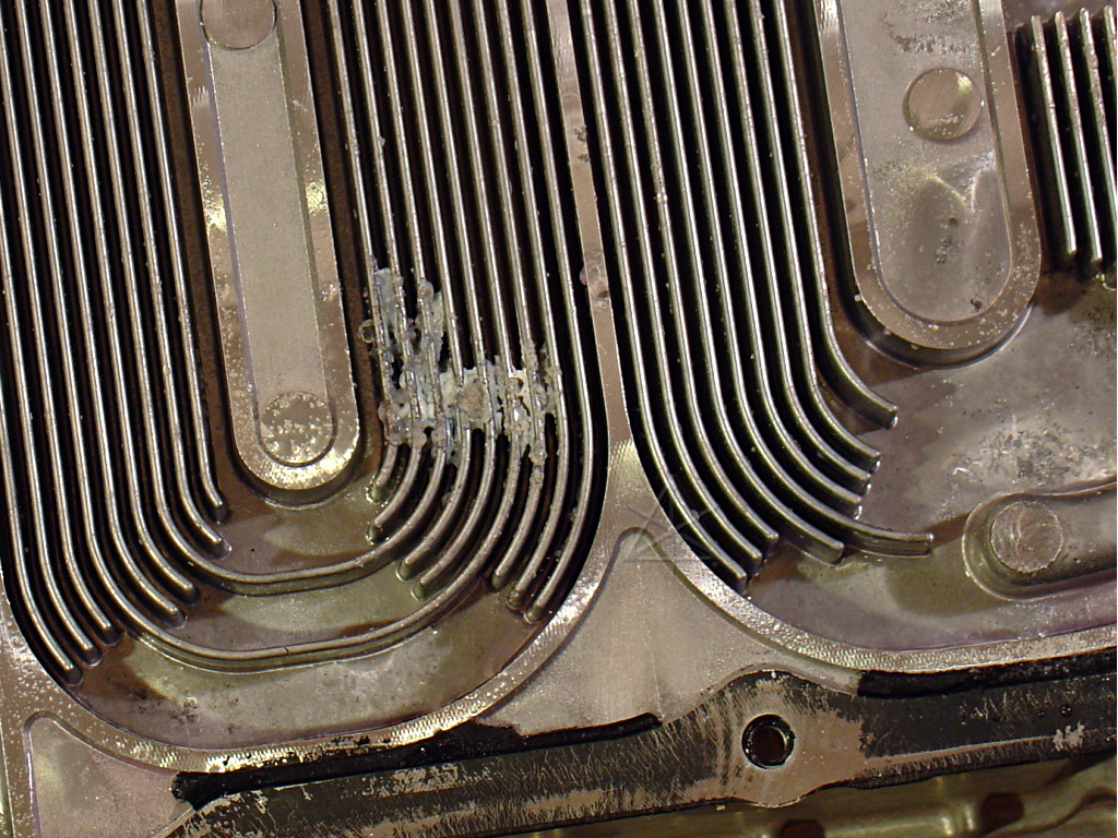

  18. PriusCamper
    PriusCamper Senior Member
    Mar 3, 2012
    13,470
    5,438
    Pacific Northwest, USA
    The images aren't related to the problem OP posted about in the thread... They are just posted to help explain that this cooling system consists of aluminum, plastic and hoses and there's nothing in the system that can turn the coolant rust colored so I'm thinking there was a mix up with what was put into the vehicle when the inverter pump was replaced.
