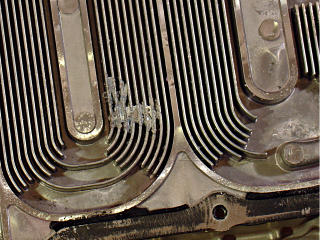

    If aluminum oxide muck is allowed to form in the inverter cooling system of a Prius, it can interfere with the cooling flow through the inverter. That also could threaten the economic lifespan of the car.

    The inverter is the hardest working device on this Car. This high tech electronics box works so hard it has its own very large coolant system.
    Many reports of clogged coolant inverter coolant systems on a g2
    From lack of maintenance.
