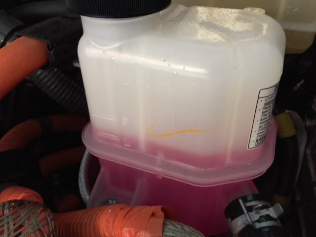

  5. sillylilwabbit
    sillylilwabbit Active Member
    Jul 16, 2015
    405
    118
    Los Angeles
    2014 Prius Plug-in
    I have the same problem as you.
    I was told to just keep an eye on it or add distilled water since it is only a couple of ounces.
    The other suggestion was if I was a hot chick I can ask the Toyota dealer to just too it off.
    I really don't want to buy a gallon and use a few ounces and just store the left over gallon for several years.
    As you can see from the pic, someone marked it, but did nothing about it.
    iPhone ?
  6. Mendel Leisk
    61,558
    42,355
    I just caved and bought the gallon. Have about .9 of it left, lol.

    Hold down a second, you own a 2013 with a very low inverter coolant?
    Keep an eye on it, if it is not because of temperature /level reading, something must be done under manufacturers warranty
