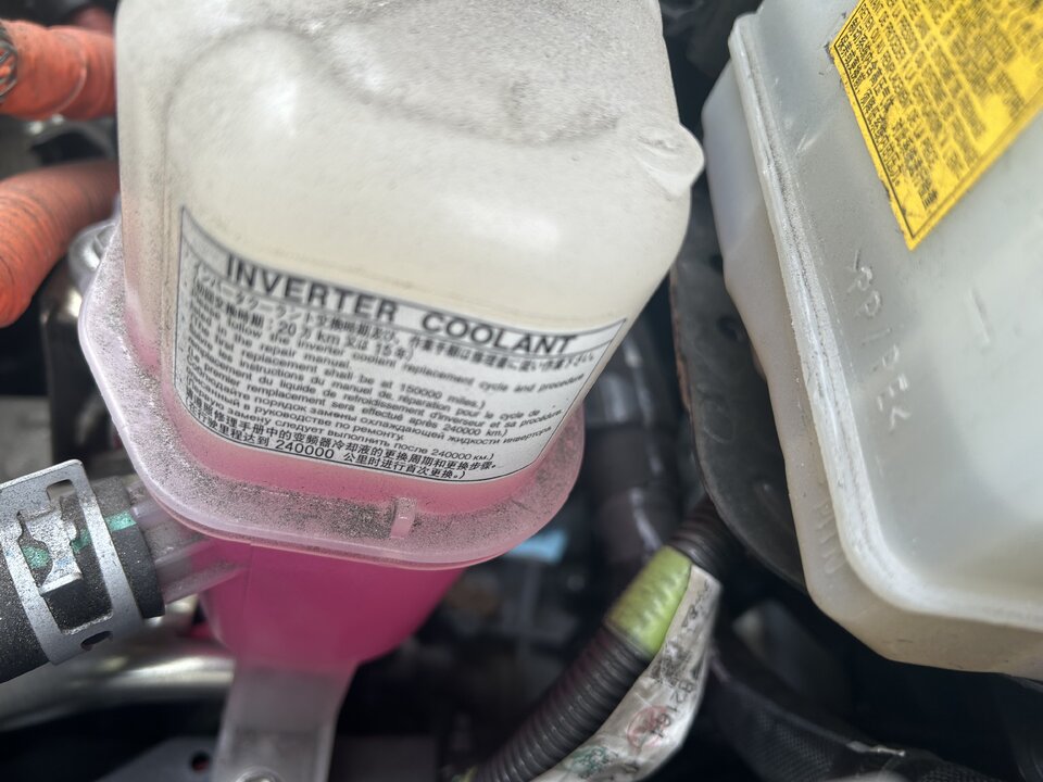

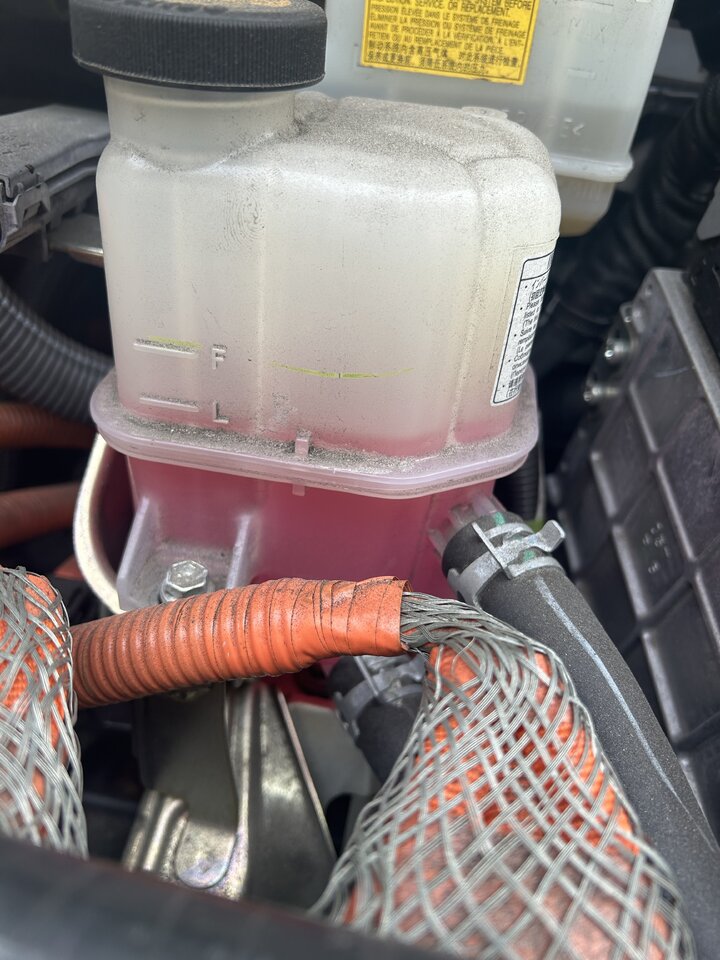

    Hello All,
    just changed my air filter and noticed the container that said Inverter coolant was filled to the Low line. Had this car for 12+ years now and never noticed, my ignorance-
    what is inverter fluid? Is it the same as anti freeze/coolant fluid? Is there a brand recommendation? Do I need to fill it to the Full mark?
    Thank you!

    Yes, the same stuff is used as for the engine coolant.

    Anywhere between low and full is ok. You could get an oil change at the dealer and ask them to top it off. Around here you can sign up for service emails and usually get buy one get one free oil changes.
