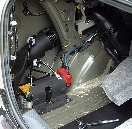

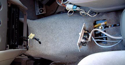

    In October 2005, I bought our first Prius, a 2003 model. The first modification in November 2005 installed a 1 kW/1.2 kW, modified sine wave inverter. We have used it at least once per year, every year since and in April 2011, 4 days and 6 hours.
    I installed a fold-down, mount so in operation, the inverter was in a normal, mount to radiate the heat. But otherwise, it is folded-up:

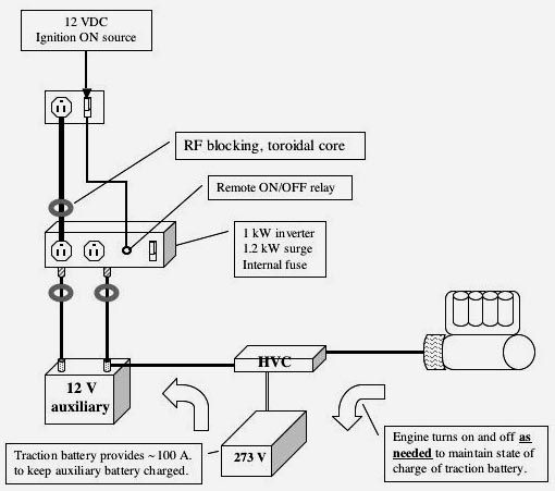

    ARCHITECTURE
    This is the overall system:
    A key design objective is the ability to provide 110 VAC power to the cabin while driving. This provides power of a laptop that can run Prius monitoring. But to achieve this requirement, the inverter was modified to add a remotely power, relay:
    Power to operate the relay is activated by an ignition switch enabled, power source, the 12V cigarette.

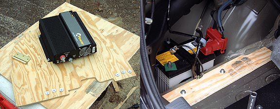

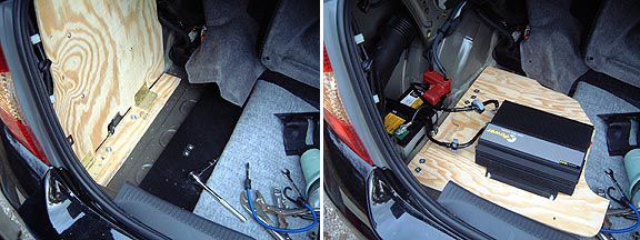

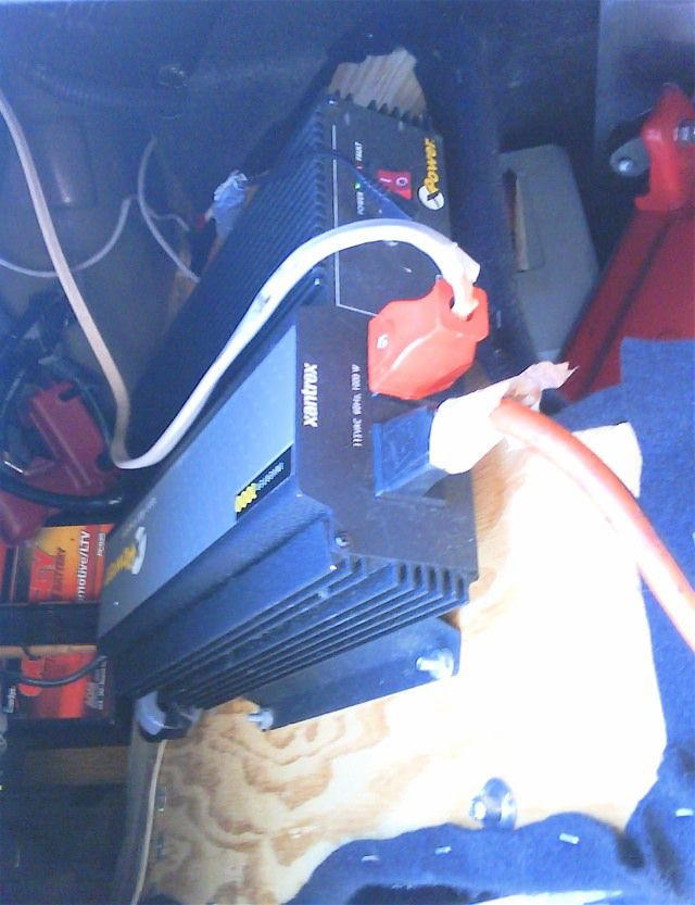

    MOUNTING
    The original, 12V mount:
    There is plenty of air-space above the 12V battery for the inverter. So I used a piece of cardboard to make a template:
    This was used to cut 3/8", quality plywood, foldable mount:
    A baseplate holding the two hinges complete the basic configuration. I did have to nibble out a ground bolt access.
    So the hinged mount folds down in high-power operation to provide plenty of cooling air. In normal operation, it is vertical:

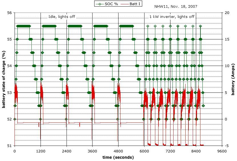

    OPERATIONAL SCENARIO
    In normal operation the traction battery provides power to the DC-to-DC converter that substitutes for an alternator in ordinary cars. This water-cooled inverter is able to operate at maximum power because it is already cooled. So normally we see this cycling:
    At minimum power, the traction battery sits around 55.5%. But when the load draws the SOC to 52%, the engine starts and recharges the traction battery using MG1, the 18 kW, unit. If the load is near maximum, this cycle becomes shorter. The key fact is the engine cycles ON/OFF as necessary to keep the traction battery between 52-55.5%. So the traction battery current switches between charge, 4 to 5 A, and discharge, -0.8 to -5 A. At maximum power load, it is almost a 50% duty cycle.
    Now this is the part the non-Prius aware people do not understand. The Prius engine only runs when energy is needed and otherwise is off. When it does run, it is at high-efficiency power point. Ordinary engine-direct, emergency power, generators are incapable of do thing. They have to partial-throttle to deal with fractional loads and this is exceptionally inefficient!
    Another fault of traditional, emergency generator is handling maximum or near maximum power. Being air cooled, they have to use fuel enrichment to keep from burning out the exhaust valves. In effect, they are adding exhaust gas cooling by running a rich mixture.
    But the biggest risk is emergency generators do NOT have a catalytic converter. Their exhaust is rich in carbon-monoxide, a poisonous gas. Every year, we read about families poisoned, some dead, because their emergency generator poisoned them. In contrast, it is all but impossible to get enough carbon monoxide in Prius exhaust except to possibly get a headache. Then there is the noise.
    The Prius is so quite it can be barely heard outside of the property line. In contrast, emergency generators have nothing remarkable for a muffler and can be heard half a block away.

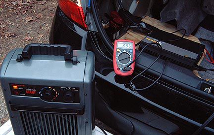

    TEST POWER
    To test the power capabilities, a resistance heater was powered by the inverter while DC voltage and current were measured:
    • 13.94 V., 1.1 A. with inverter OFF
    • 13.94 V., 1.7 A. with inverter ON and no load
    • 13.83 V., 50.3 A. with heater on lowest setting (~ 700 W)
    • 13.75 V., 71-74 A. with heater on medium setting (~ 1 kW)
      In this mode, the inverter ran at normal temperature in the 50 degree (F) evening. The system was stable and ran without a problem or attention. This is the mode used for the fuel-burn testing.
    • 11.48 V., 89-90 A. with heater on high setting (~ 1 kW)

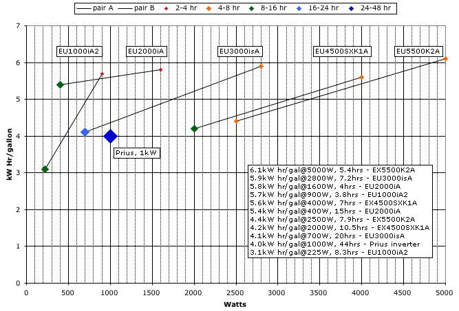

    So this is how it rates relative to other emergency generators:
    So it is certainly competitive. Best of all, you can drive to the a gas station to fill-up when bad weather is forecast.

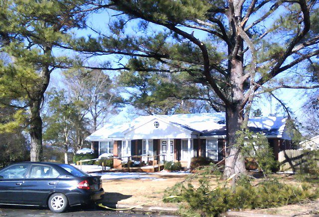

    It is for house emergency power. We have had at least one power outage every year and used the Prius for emergency power:
    • six weeks ago - equipment failure led to a 4 hour outage with low, 40F, outside temperatures. The Prius provides enough power for the 700W, gas furnace, fan.
    • April 2011 - tornadoes tore up the TVA transmission lines and we camped out at home 4 days and 6 hours.
    • summer heat - it can power a 5000 BTU, window air conditioner in the bedroom so we can sleep.

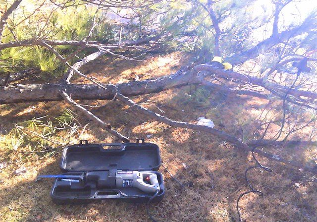

    The cabin power only needs to provide less than 50W to power the laptop. At that low level, I'm not worried about heat in the trunk. But when providing house-power, the trunk is open and the inverter laid down for optimum cooling.

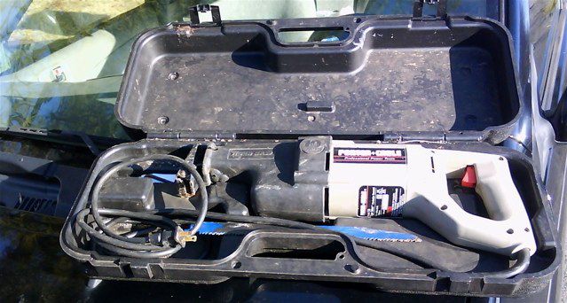

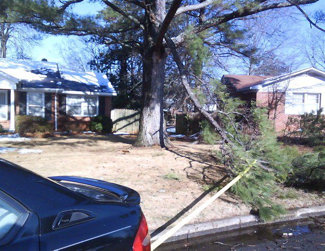

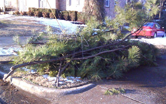

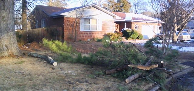

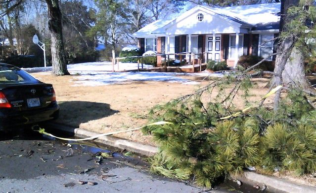

    This has also turned out to be useful at remote sites and when trimming trees on our property:
    Redpoint5 likes this.
