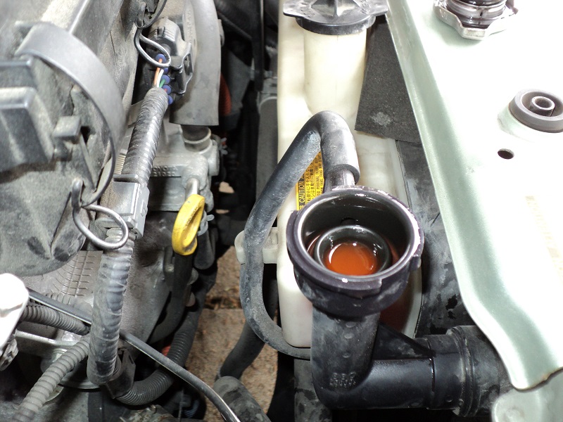

    Here is a picture of what the Gen II Prius radiator will look like when it is full. In order to access the cap, you must remove the splash guard over the radiator first. Don't forget, only use Toyota SLLC.

    If you were viewing your Gen II as looking at the pic above, the bleeder screw would be found on top of the radiator about two feet away towards the drivers side on top. Look for the warning label. It looks like a little hex head screw that can be seen through the metal over the radiator. Can't describe it any better than that. Open the bleeder when filling the radiator. This helps to remove air pockets.
