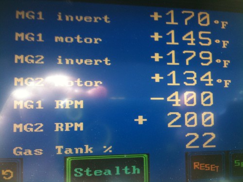

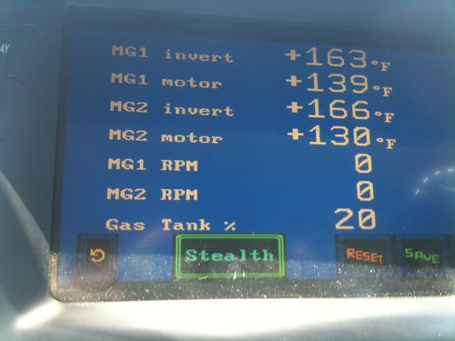

    Over the past 48 hours, with my CanView I've noticed that my inverter temps have been above normal. Initially I was seeing 110-120sF which didn't frighten me, but it was clearly higher than typical unless doing some major regen or EV mode driving on a hot day. Yesterday I noticed the temps were closer to 130-140F which is definately abnormal, I don't think I'd ever seen it hit even 140 before. Today on a bit longer drive into town to get my kids the inverter was getting up to the 180s (see photos) which really did freak me out. But I had a mission that couldn't be aborted.

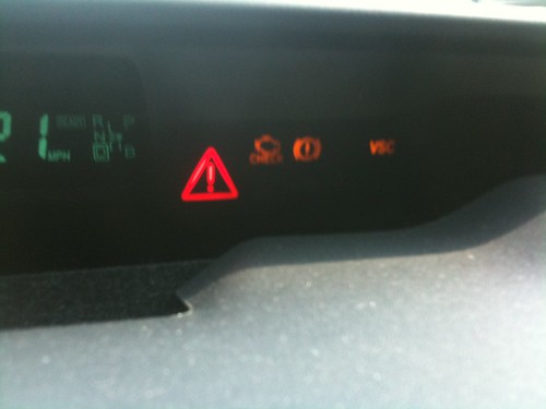

    On the way back I was running the AC pretty cool (75F) b/c the kids were hot from soccer camp and it was clear that the inverter was getting hotter climbing toward and eventually exceeding 200F. I saw peaks above 220F and shortly thereafter the master warning light, CEL, VSC and about everything else came on and remain on.
    The car continued to run, but eventually the AC stopped kicking out cold air, so I just shut the thing off, which seemed to help the inverter cool down some. (back to the 180-190 range).
