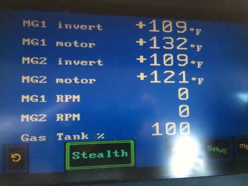

    Here are the temps post replacement of the coolant pump...and this is in 100F outside air temp and normal driving.

    As far as how hot the inverter can get before you have to worry, a good rule of thumb is if you can hold your hand on it without being burned it's ok. If not, worry! As an electronics tech this is how I determine if I need to take cooling action on equipment, when I don't have my gauges/meters with me.

    Well the OP said his inverter temperatures peaked at over 200F so I don't know how reassuring that's going to be for him. Try holding your hand on metal at over 200F and see how long you last. :eek:
    I agree that's too hot though.
