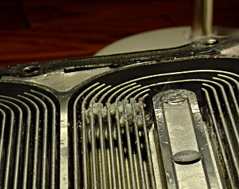

    What might be the best way to potentially clear such a blockage if it did exist, would successive changes with toyota SLLC do it?
  14. 05PreeUs
    05PreeUs Senior Member
    Oct 1, 2016
    1,097
    565
    MSP
    If the inverter is isolated from the rest of the system, it is possible a simple garden hose in reverse-flush could dislodge the garbage, but if it is some type of stop-leak product, who knows.

  18. ChapmanF
    28,754
    19,061
    Isn't that the photo from hobbit's inverter teardown?
    I didn't get the impression it was stop-leak. The aluminum anode rod in my water heater grows what looks like the same stuff. Aluminum oxide ... hard and crusty when dry, but blobby like jello when formed in water.
    If I had to guess, I'd guess the coolant wasn't changed in too long, had its corrosion inhibitors used up, and started munching on some of the aluminum.
    While the stuff is still blobby, I would guess a forceful flushing pump might help.
