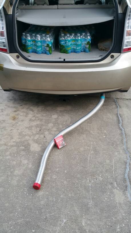

    I did get a six foot 2" exhaust pipe flex and exhaust clamp. I will have it venting outside the garage. [​IMG]
