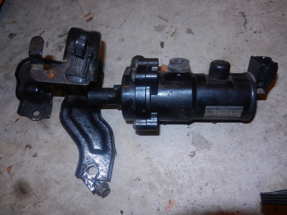

    I have purchased a new pump from ebay , Toyota Prius Inverter Pump | eBay
    But the one I took off looks completely different did they update the part I noticed its a different part number too but says it fits a second gen Prius .

    You have two different inverter pumps. The long one attaches to the canister in the drivers side wheel well. The round one is located behind the left head light.

    The eBay listing is for the correct inverter coolant pump, which is located behind the driver's headlight assembly and in front of the main relay/fuse box. However based upon the photos I would say that listing is for a used pump, mounted on a shiny metal bracket from a new pump, and placed into the box that the new pump came in. It is a waste of time to install a used pump with who knows how many miles logged on it.
    Your photo in the OP is for some other pump, not the inverter coolant pump. Where did that pump come from?
    Please provide a photo that shows its location in the engine compartment. What did you have to remove to get to that pump?

    I`m changing my brake actuator so my invertor is out . Its located directly to the right of the brake actuator and figured since I have it out I may as well change it . The bracket that its located on needs to be removed to replace the actuator itself . Also your right its not an invertor pump its the heater water pump .

    Thanks for the info. So this coolant pump is mounted on the firewall?
    There aren't many reports of this particular pump failing; however there are occasional posts from people complaining their cabin heater is not working very well. An engine coolant valve failure is one reason for this. I think that this pump may also be a reason occasionally.
