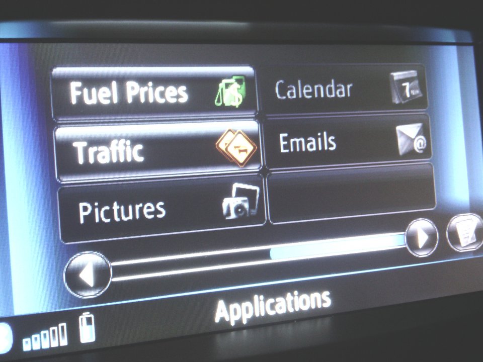

    Are you guys talking about what I see grayed out on my display?

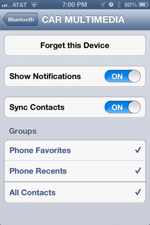

    Your in the wrong screen.
    1) on your iPhone go into settings. Go into Bluetooth. Show notifications put ON. see picture
    2) turn the entune app on
    3 connect the iPhone to your car via USB cable
    4) have someone send you a text message
    5) the message will appear on your car multimedia screen
    6)on the car multimedia screen the message will have about 20 respond messages select one and transmit
  9. vsuirpsteve
    vsuirpsteve Junior Member
    Jun 18, 2013
    32
    Coooly...ok that works...what about the calendar and picture thingy?

    I don't have that on my car. Maybe someone will pick up your question and respond. Looks like you can sync your iPhone calandar, photos and emails. Now that is Awsome :)

    u cannot do pictures and calendar, no support on phone
