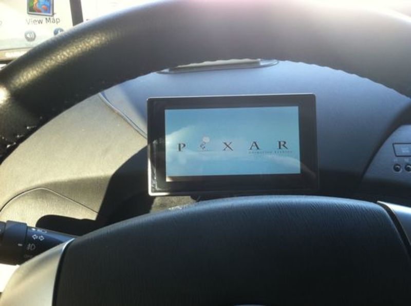

    Just thought I'd share an install for a 5 inch screen for movies. I'd like to note that no I do not advocate any kind of video player that is in view of the driver in any vehicle (it's not even legal as far as I know). My car however is a 5 with ATP and I will only use the screen when on a highway with DRCC and LKA enabled. I know this is still not safe, but it's really more for listening to the movies than "watching"
    Screen installed on top of steering wheel column:

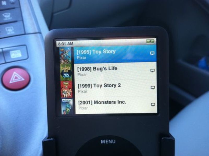

    iPod dock:

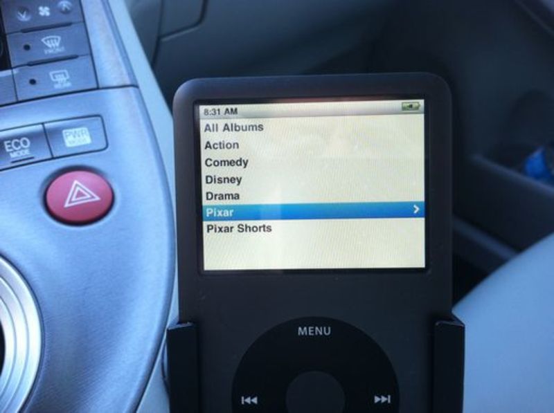

    Genre list on the iPod:
    Movie list:

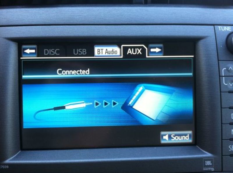

    Car is kept in aux mode to hear the audio:
    To get this to work I had to use an apple video cable which is connected to the dock below my shifter. The video out ultimately goes to the screen and the audio out goes to the aux-in jack in the center arm rest console.
    The reason for the external dock is unfortunately I cannot use the cars ipod usb connector in the arm rest. The audio and video are way out of sync when playing a video this way. So I had to use the aux-in line instead. So this also means I cannot use the nav screen to browse or play the movies. It has to be done on the ipod itself, so the dock is in a nice place that is easy to see and get to.
