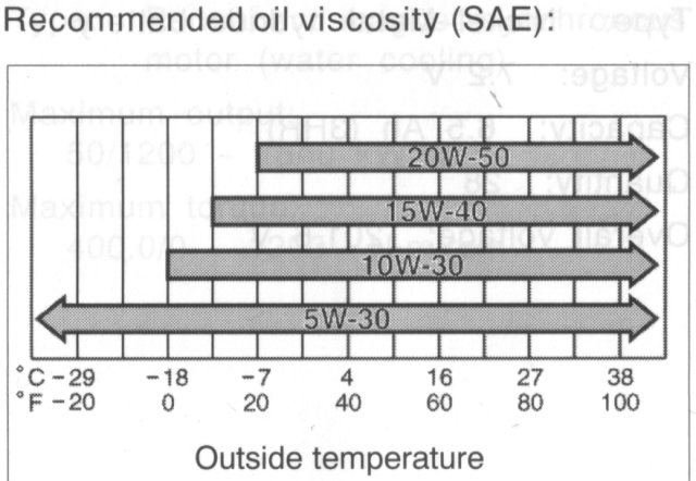

    BTW. Here is a scan from the users manual (Australian) of my 2005 Prius. Notice the wide range of suitable grades as indicated by Toyota, and in particular notice the lower temperature limits applicable to each grade.

    let me say that chart does not align with what I've seen for the US. Why does the 5w weight has a clear band of application beyond the 7 degree or so difference you indicated that you'd gain? I personally would never even think of 15w or 20w in a prius as suitable -- edit maybe summer time if your ambient air temp is really high. 20w-50 I don't think would be ideal or recommended for a prius at any time by toyota so is this chart is for a prius?

    Toyota's recommendation for prius gen 2 in Australia is 5W30 all the way up to 20W50.
    USA has CAFE, thus 5W30 only.
