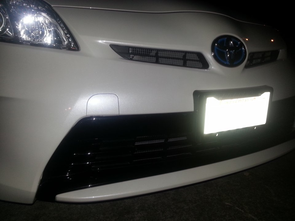

    Car is only 5 months old, and all the panels were intact. Definitely just a dose of bad luck. Following the instructions by a fellow PriusChat person, I installed 1/4" mesh (same stuff I use on the race car) down from the top near the hood latch for all 3 frontal openings. Doesn't look half bad, and you don't notice the black tie-wraps unless you are reallllly looking for them.

    Finished in the dark....so crappy cellphone pics are all I can muster at the moment. I should have taken pictures to show the access technique and attachment technique I used, but just too tired. I removed the license plate in order to have better vision to where I was putting the black tie-wraps. Pictures coming in about 15 minutes.

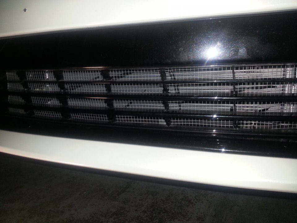

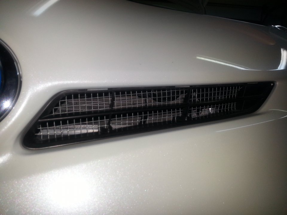

    If you look closely, you can see that my mesh wasn't quite wide enough, so I had to stitch an extra 3 inches on the right side - so there is some overlap that I safety wired together. If it bothers me looking forward, I'll redo it. I just didn't want my wife to drive another day without some protection. (Upper left if just the license plate hole).
