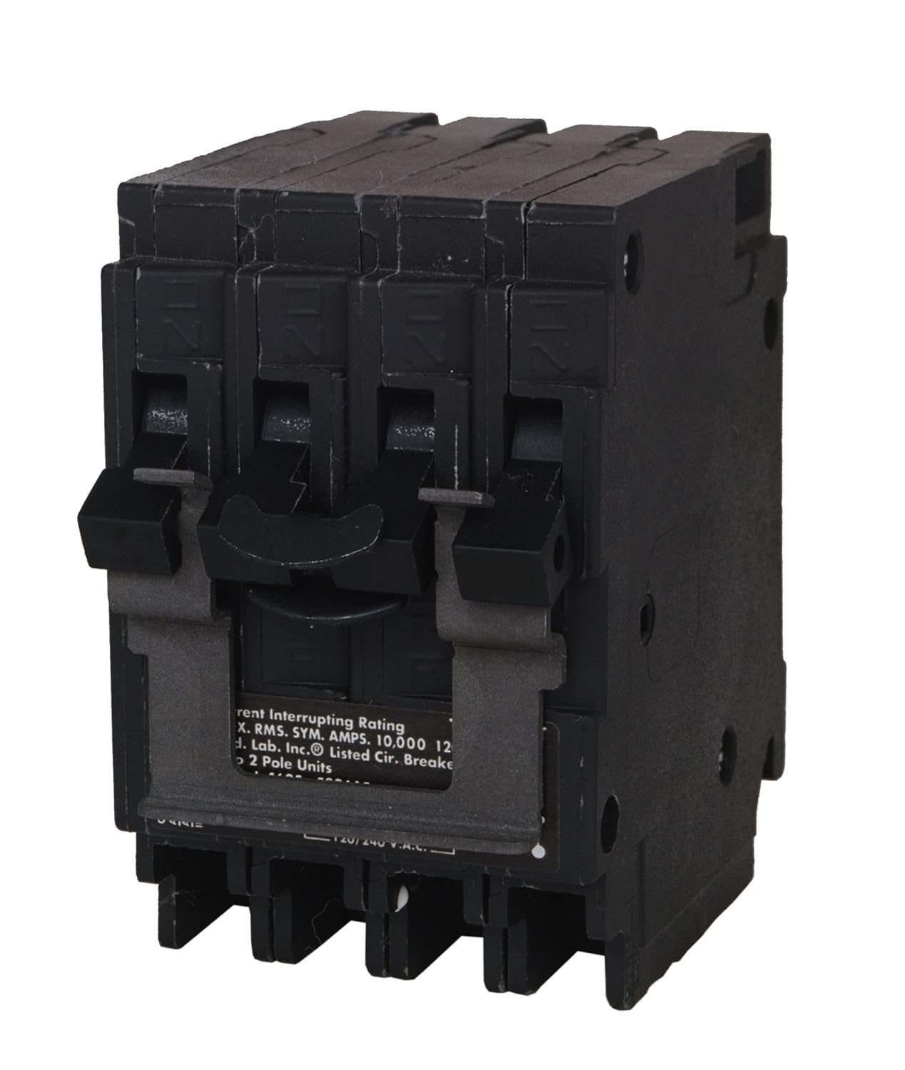

    Be aware that adding an additional load to a Load Center is quite easy using a doubled up 220V dual breaker like shown below. For example, a 20 Amp dual (i.e. 220V) breaker can be replace with a combination 20 Amp/50 Amp breaker. The 50 amps can be used to supply the EVSE. Of course the wiring for the 50 Amps needs to be added and hopefully not every single 220 Amp breaker in the panel is doubled up already.
