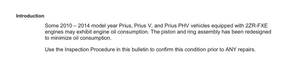

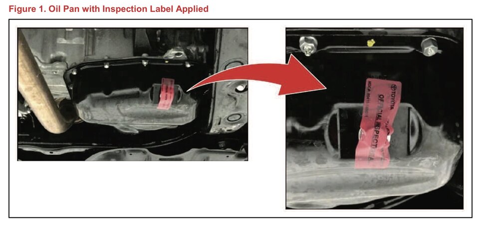

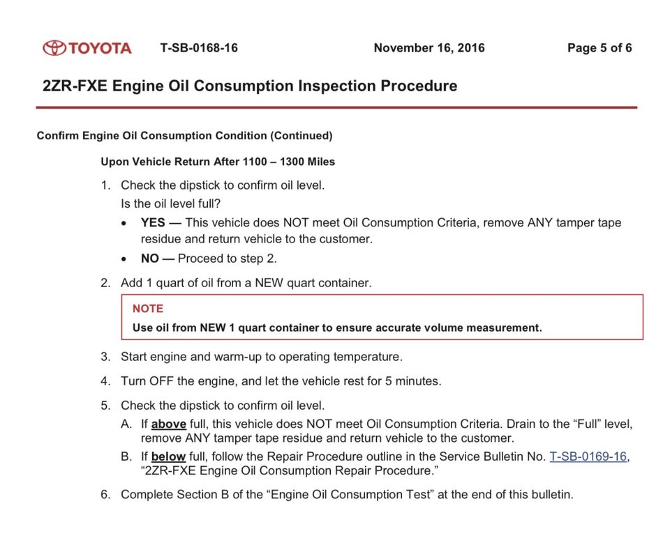

    When Toyota was rebuilding gen3s due to excessive oil consumption, the metric was a minimum of one quart in 1100 miles.
    Toyota had seals they would install on the oil drain plug, filter and dipstick to ensure the owner did not remove oil during the required 1100-1300 mile test period.

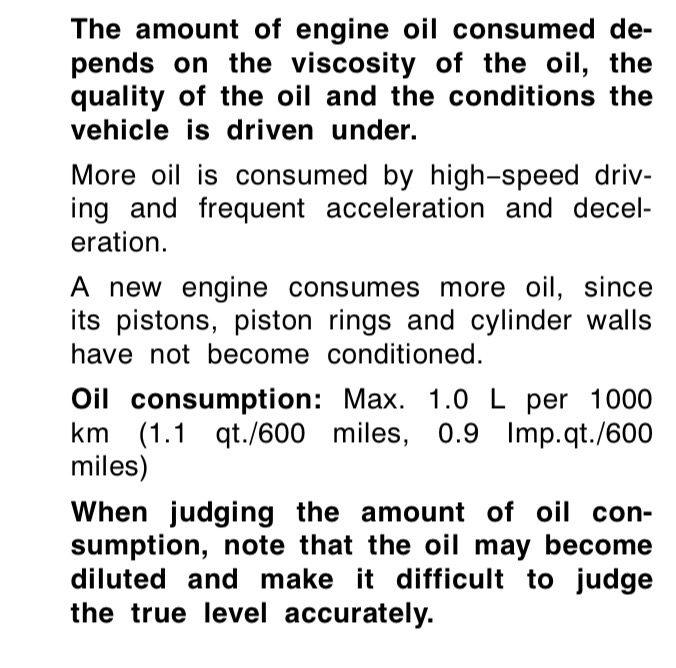

    Right you are, from page 325 of the North American, gen 2 Owner’s Manual. :rolleyes:
