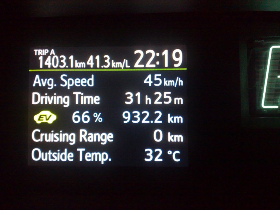

    I'm also running in EV as much as possible (66%), here is my picture in the Top 20 - MPG Record Holders.
    FE (MFD) = 97.1 mpg
    FE (Calculated) = 90.7 mpg
    The top hypermiler, ufourya, has his EV at 78%.
    IMHO, if running at low speed and low load conditions, EV is my preference. No doubt the battery has to be recharged, it is still more efficient than running all ICE in that type of conditions.
    Vincent

  5. vincent1449p
    vincent1449p Active Member
    May 24, 2004
    894
    332
    Singapore
    Our traffic does not permit me to do gliding, so most of that is constant speed EV or neutral. As you can see, my avg. speed is much higher than ufourya.
    Vincent

  8. fuzzy1
    17,947
    10,724
    If that is mostly constant speed, then it pretty well matches Bob Wilson's mpg-vs-speed graph for the liftback. So no surprise.
