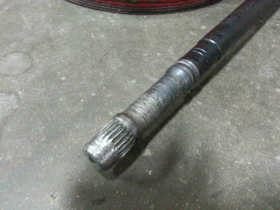

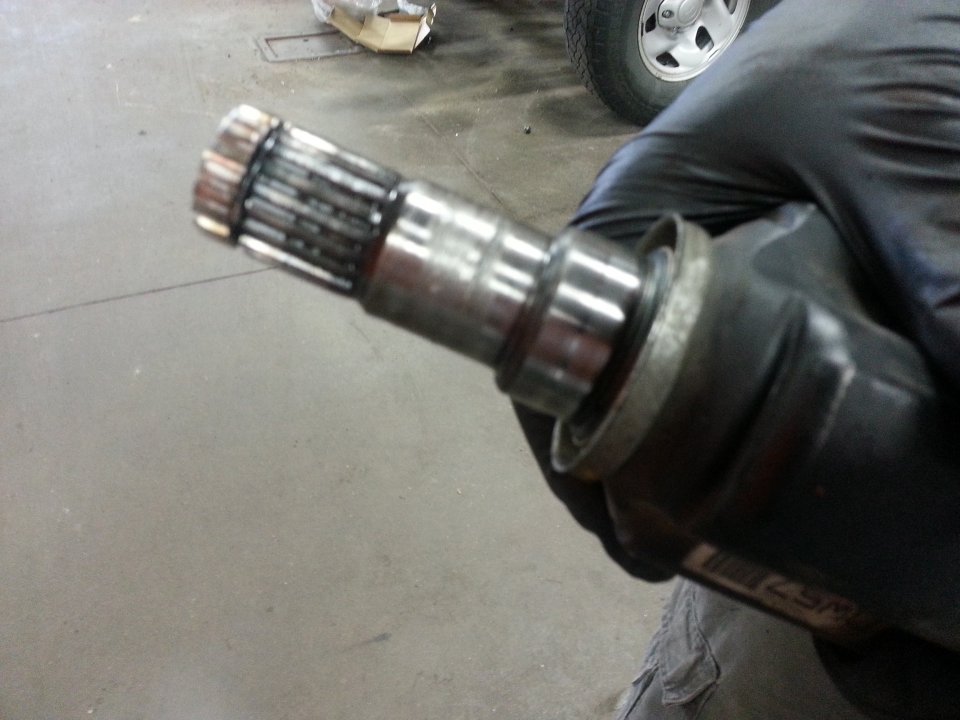

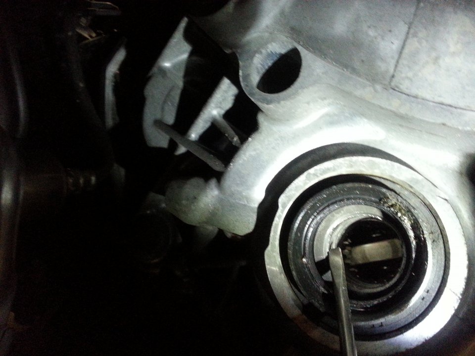

    Thank you, is it normal for an axle to damage the transmission, and require a brand new one? Based on these images the toyota dealership reported that I need a new transmission. They reported that the external area where the axle goes into the transmission is scored and needs to be smooth in order to work properly. Here are the pictures I have taken.
    Can this be fixed, do I really need a brand new transmission?!

    Is this car parked in a garage? Wherever it's parked, look if there's red fluid stains on the ground. It may be that you had an axle seal leak for a while and the dealership didn't bring it to your attention. Damage occurs when the fluid runs low. It has nothing to do with your hybrid system.

    I don't know if it leaked. My uncle told me that he never heard of an axle damaging the transmission especially since I was going at low speed. The dealership said it was a rare occurance and that my axle did not go straight into my transmission which caused the scoring. Another hybrid mechanic said he has never heard of an axle damaging the transmission either. And if it did, it should be fixable and not requiring a full replacement.

    Anything is possible despite what your uncle says. You should take to a hybrid shop for a second opinion. Perhaps some kind of tranny repair is possible. Dealerships don't repair trannies, they just swap parts.

    You can do a search on prius axle seal leaks. You probably find lots of info. At your mileage, that would be the only thing that makes sense

    But would it have damaged the transmission? should i even try to salvage my car or just sell it? its 87,000 miles.

    yes low fluid will 100% damage the transmission.

    I've spoken to many mechanics, all saying something different about whether a damage to the axle would cause damage to the transmission.
    Some mechanics look at my photos and say outright that I do not need to replace the transmission and just need a new seal. A transmission specialist said it's rare that I would need to replace both, something is fishy. I should just put in the axle and see if it fits in the transmission. Drive it around a bit, if it works, it works. He said there is no way to actually see transmission damage from the outside.
    Other mechanic said that in the photo he can tell the outer case output shaft bushing, spline, and differential are damaged. Instead of purchasing a new output shaft, a new transmission is faster and less costly since the only way to replace the output shaft is to take out the transmission. Then he said there could be possible inner damage as well and may need to be rebuilt. Replacing with a new transmission is the best way to go.
    Still not 100% what caused this.
