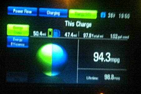

    Maybe not 50mpg consistently.. but his pic was not too far off
    And that was mostly at highway speeds and cold.
    With respect to the BSFC, in
    VOLT MPG estimate using BSFC maps
    George did an estimation showing 46.7MPG. And he did not push the RPM to WOT, but used a more realistic setting.
    Not sure why you claim the Volt has more conversion loses, as when its in two-motor ER driving its power-split design is nearly the same as a Prius, and at higher revs is splitting its power between drive and generation. To see how the volt power-split works Check out
    Solving the Volt
    Yes an Atkinson Miller could probably do better, than Otto for the Volt, but that was not the question.
    The mass is more of an issue for city driving than HWY and the discussion of approaching 50 was only for HWY.
