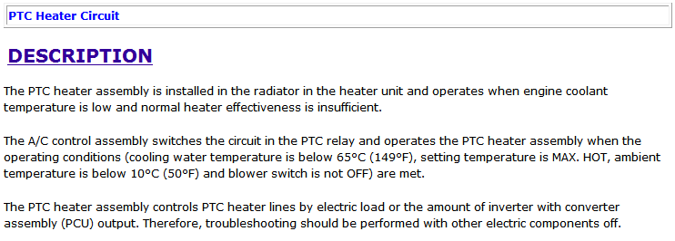

    Are you sure about that? The repair manual has information on the PTC heater, which is what GrumpyCabbie is thinking of, I believe. It does have the usual "if equipped" notes, so it's probably a regional thing, but it presumably must be included in some regions...
    At least on the Gen II, it was only 165 W though, or about a tenth as much as a hairdryer. Those heaters are really only meant to give you a little bit of window defrosting ability right when you turn on the car - you probably won't even notice the temperature difference.

    I believe all models have the Positive Temperature Coefficient heater, but the following specific conditions (2nd paragraph) must apply:

    Yes, that's correct - though it's worth noting that the MAX HOT noted here is not the temperature setting that you see on the display, but rather the air mix damper inside the A/C system; basically, it's trying to get as much heat as possible from the heater core, and no air is bypassing the heater to moderate the temperature.
    A PTC heater refers to a specific type of electric heater. The coefficient that is positive relative to its temperature is the resistance - so the hotter it gets, the higher the resistance becomes. Because the voltage applied is constant (probably 12V), this decreases the current (Ohm's Law; V=I*R). The equation for power is P = V*I = V^2 / R. So as the resistance increases (and current decreases), the power dissipated in the heater will decrease.
    The net effect of this is that this heating element doesn't require anything else for a thermostat - it limits itself from getting too hot. Other electric heaters need some sort of thermostat, and a safety in case the thermostat doesn't work right.
    (That's actually what broke my wife's coffee maker. It was getting too hot*, and so one of the thermal cutoffs blew. Being the good electrical engineer that I am, I took it apart, removed the thermal cutoff, and shorted it instead. Then the other one blew, and I figured it was a good time to get a new coffee maker.)
    (*Or maybe the thermal cutoffs got too old. Either way, a PTC heater avoids this sort of failure by just not requiring any sort of separate temperature control.)
