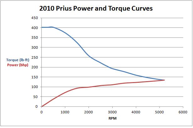

    Lets assume this is the HP curve of a stock Prius. it is clear that M/G1 can counter both the 131 HP and the 400 Ft/Lbs of torque because it does so stock. If you size the turbo Area/Radius small, it will aid the low end and minimize lag, but not add to the peak HP, improving the curve below 5000 RPM. (this is the result the magazine articles report)
    Turbine housing A/R and sizing | Turbobygarrett
    Since we do not know that the transmission and M/Gs can take more peak HP, the strategy should be to beef up the curve from 1000 to 5000 RPM and let it choke for air at higher speeds. (again this is what the articles report. He uses blowers and turbos from VERY small engines) A Prius with successful forced induction will spend more time with the HV battery charged, as M/G1 spends more time countering the engines power.
    This is a very hard project and not a Kit, but the real reason no one attempts it is we want more MPG not more HP.

    I'm not sure that the 131hp and 400Ft/lbs at the wheels of torque is relevant for MG1.
    MG1 has to balance the 95 NM (~70 ft/lbs) of the ICE. Over the operating curve this only varies from 75 to 95NM.
    Obviously Toyota would have built some margin into the design but since it is never expected to do more than 95NM it may max out at only 10-15% beyond that.
    Even if MG1 is within its capabilities, under normal cruise conditions, as you say, it will depress the ICE RPM to produce the required power (although it will actually be consuming power - MG2 will be producing the power to feed to MG1) - this could have two disadvantages;
    Even as designed I find the engine is only operating at 1400-1500RPM at cruise - if this is pushed lower it starts to get into the area of worse BSFC. Secondly more of the power will be transmitted through the inefficient electrical path (~80%) rather than the mechanical path through the PSD (~95%) , increasing losses.
    In spite of my objections I would be very interested in it being made to work.
    kevin

    Transmissions are rated in terms of their Tq capacity, not HP. Hp is nothing more than a mathematical function of toque and the RPM at which that tq is applied. Clearly the transaxle can handle 400lb-ft and most likely somewhat more, but given the costs involved in discovering the upper limits.....
    For Gen3 they went to the same parts, minus the chain drive, so gear-to-gear for the final reduction. I would suggest there may be an engineering reason to that change.
