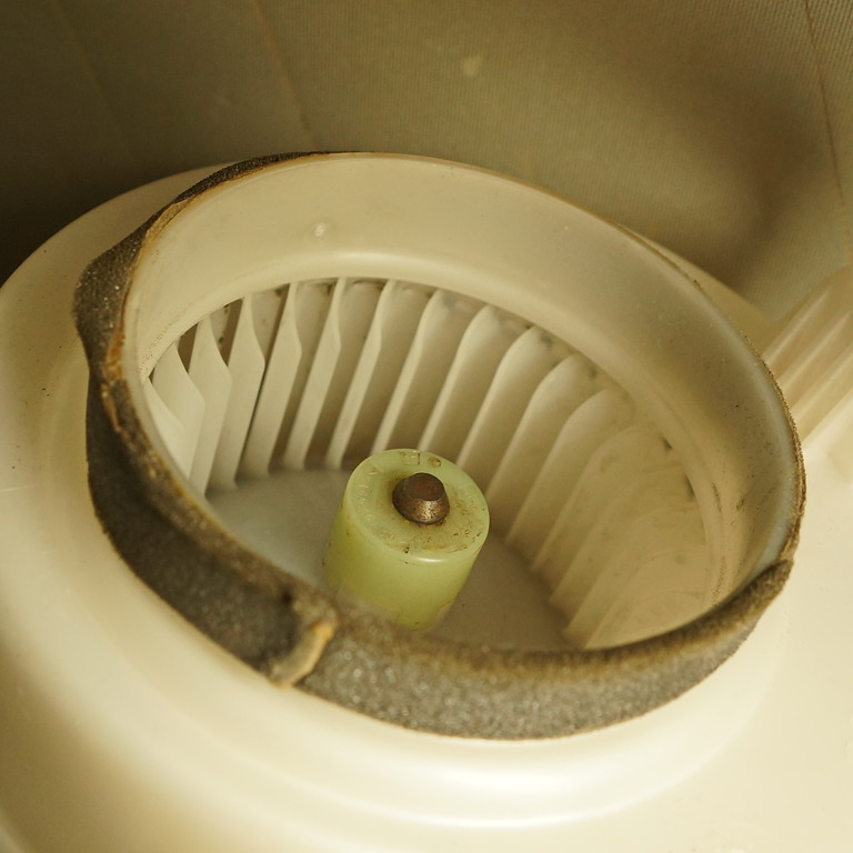

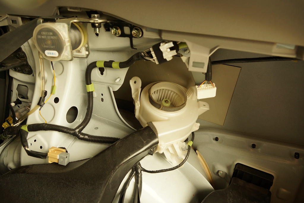

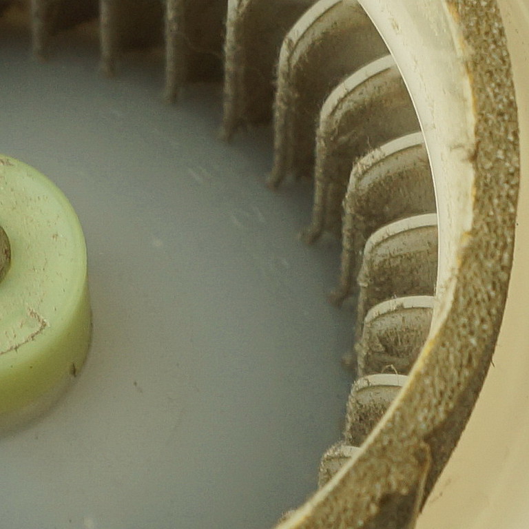

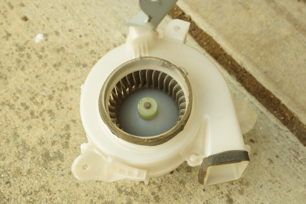

    I cleaned the fan today. It was actually pretty clean considering 7+ years of use. The good news is if I end up replacing the HV battery I've already experienced about 90% of the tear down needed. It was also a good opportunity for a deep cleaning, especially considering areas exposed which are normally not accessible for cleaning.
    I spent about two hours total, including shampooing the rear seat and the rear carpet pad.
    Cooling fan prior to cleaning
    Not much dirt considering 7+ years of nearly daily Prius use.
    Cleaned and going back into the car
    Cleaned cooling fan
    Waiting for the cable and software...

    Yeah that didn't look too bad. Was still worthwhile cleaning it though. :)
