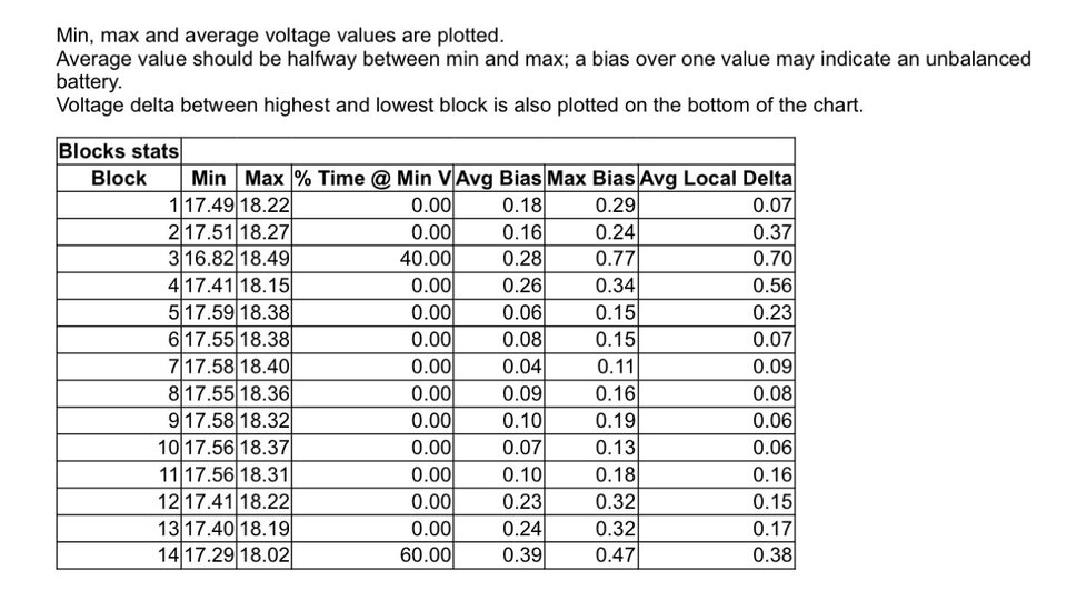

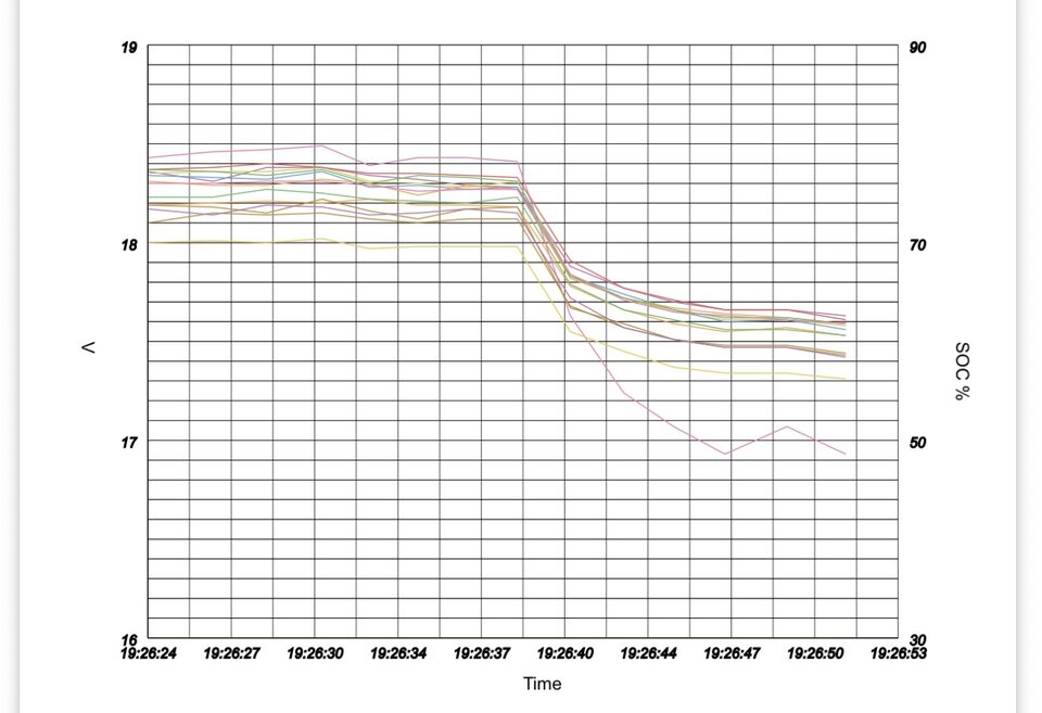

    I have a Prius 2008. It has close to 115K miles. The car is showing red triangle on the dashboard and giving P0A80 code. Is it really the battery failure since it has such low miles? I used Dr. Prius free version and Hybrid Assistant apps and have attached their screenshots here. I am new to Prius so not sure if the whole battery needs to replaced or just some cells or is something else causing the battery to look like it has failed.
    If the battery needs to be replaced what is the best option and what kind of battery or cells or what seller offers the best quality batteries? I am totally lost. Some batteries are for $900 some are $3400. My vehicle is stalled it is overheating too when it runs so I am not driving it anymore.
    I have attached the screenshots for someone to help me understand if it is really the battery or something else.

    The number of miles driven is less important than time in service. Have you verified that the odometer is reading the true distance this car has travelled?
    Looking at your screenshots, I wouldn't be surprised if you found that the battery has been monkeyed with by someone prior to you acquiring it.
    Yes, your battery requires work or replacement. The best option is to replace it with a new OEM from Toyota. (I would do this if the car is in premium condition and you are 100% sure the mileage is genuine.) Everything else is a crap shoot. If you do not have the money, but have time, you could spend many weeks doing a refurbishment. Be prepared for a lot of study and trial and error.
    Block 3, which contains modules 5 and 6, is definitely very unhappy. One of the modules, if not both, needs to be replaced. There could be other modules you should replace as well.

    The battery is not going to cause the engine to overheat if that is the concern. That is the number one problem to resolve as it could ruin the engine.
    The battery temps in your pics are unrealistic especially the -521f.

    If that isn't a problem with the tool used to read the value, then it indicates a problem with the sense wires and/or CPU inside the battery. Corrosion inside those wires and that CPU are fairly common problems, especially in humid locales. That said, if that is the original pack, even if you were to fix those problems (replace wires, CPU, maybe new nuts for the modules) it is unrealistic to expect it to work forever. It is currently 18 years old, which is really pushing the lifetime limit hard. 1700 is a great price on an OEM battery, and if you are at all handy and have some common tools changing the pack oneself is doable. That would also replace all of those parts mentioned above with brand new ones. Having a helper for moving the pack in and out of the car helps though. Also, the old one must be an OEM battery or they won't give you the core deposit back. If you do decide to change it, inspect it when you pick it up at the dealer. The first one I got had apparently been dropped and the plastic "railing" along the side of the modules was broken, so it had to be returned. (This is not a common problem, I have not seen anybody else post in this forum with the same issue. )

    The attachments are not much help on the battery but these 2 pages might show an imbalance.
    A better view of the data is available from Techstream or your Dr Prius bluetooth app. However your code is definitive enough for a dealer to replace it.
