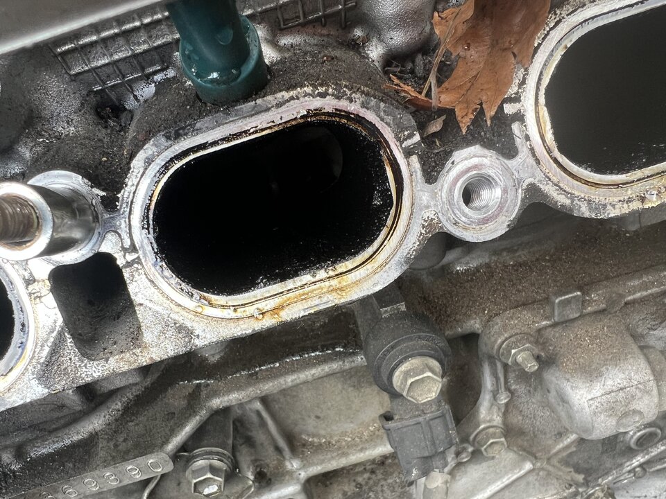

    My steps: All of them down to snug fit, then center, left outside, right outside, inner left nut, inner right nut and repeat until 21 ft lbf (As per the manual).
    Is there a factory recommended way or better order?
    I have a possible air leak somewhere and it is now throwing codes after clean install.

    Nope and you have a pretty good amount of silicone gaskets sticking up out of the groive area . Somlenty to. Make the seal.

    I ask because I just swapped in a cleaned egr and manifold and it started throwing error codes sputtering, puff of smoke and engine shut down (check hybrid system warning on screen). This is the second one I have done in the last few weeks and same as the first swap did something similar. So I had to remove everything and reseat all the parts then it worked fine.
    I am getting pretty quick at the removal and replacement though.

    Yeah these plastic intakes are pretty nice they go on and off pretty easily minimal fuss . No buried fasteners and all of that stuff
