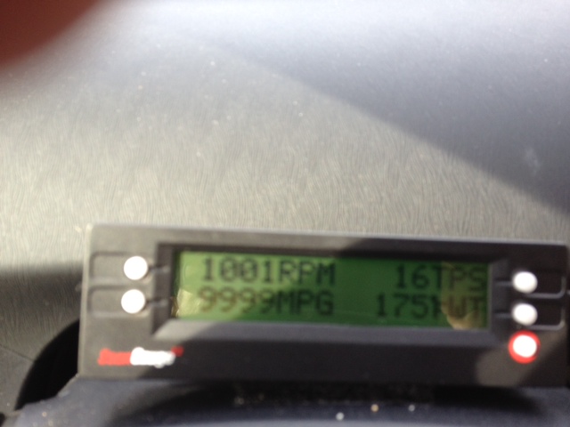

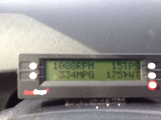

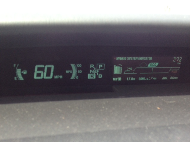

    I took both of what you said, and decided to test it for myself today. I found out something very interesting. First let me describe the conditions. 6-8% downgrade in Blackhills from Deadwood to Spearfish. Grades is steepest for 2-3 miles then shifts to maybe a 3-5% grade for another 2-3 miles. Total Downhill is 5-6 miles. Speed limit is 55MPH. Temperature today 80 degrees. No wind that I could notice.
    First Test: 60MPH glide (foot off accelerator) in "D", and some extra pedal regenerative brakiing to keep speed at near 60. Picture shows 9999 MPG.
    2nd and 3rd pictures show same 60 MPH in "N". Only 334 mpg securedownload-8.jpeg
    Test was repeated 3 times. When in D, instantaneous MPG was 9999 vs. 334 MPG while in N. Never could get the ICE to shut off in N.
    I believe the difference is that in D, the computers in the Prius is figuring in the value of regenerative breaking storing potential energy which is occurring when the speed is maintained at 60, and when in N there is not regenerative braking, hence there is no storing of potential energy. My conclusion is that it is more efficient to keep the car in D than in N when on a steep decline if you want to maintain speed limit (or close). I see very limited value of using N in this circumstance. Even if not using extra regen braking to slow your speed down to under 80 in this circumstance, driving N has no advantage in my eyes.
    Now, in a constant 1% downgrade, Bob contends one may not have to fiddle with the pedal if you use N in that circumstance and that may be very well true, but then you have to fiddle with shifting. I do see a bit of value in using N if in JUST the perfect circumstances where braking is not needed, boosting the battery is not needed, and speed can be maintained at a level that is either street legal or goes with the flow of traffic. This is somewhat limited usage, but probably occurs more often than one may think, and may become automatic in usage if a hypermiler gets in the habit.
