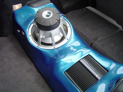

    Well, it is in. It sounds great but admittedly not nearly the volume I hoped/expected. It has more volume than the self powered unit I had in the tray no doubt and plus because it is not in the tray, nearly all the rattles I had before are gone.
    I did add a block of foam board to reduce my volume from ~20 liters to about ~16.
    The amp is running 100-150 watts RMS less than the Hertz is rated. That could be a lot of the volume problem.
    Before you ask... yes, I will finish it up this spring when it gets above 0! Not sure if I will go carpet or just gel-coat and paint.
    Glad I am nearly done!

    you don't need to gel-coat it to paint it. You'd have to sand off the paint.
  15. spiderman
    spiderman wretched
    Jul 5, 2009
    7,543
    1,558
    Alaska
    ? If I paint it, I want it to look this smooth:
    full thread here.
    I don't understand what you mean in your second sentence...?
  16. mgb4tim
    mgb4tim Noob
    Jul 8, 2009
    1,153
    111
    Pittsburgh, PA
    you'd have to sand off the black paint you used, unless that's a resin dye.
    You can get it that smooth with body filler. Knock it down with a rough roloc disk, and start the filler/sanding dance.
    But, just some food for thought - being in your trunk, the littlest thing will scratch and mar the paint.
  17. spiderman
    spiderman wretched
    Jul 5, 2009
    7,543
    1,558
    Alaska
    Ah, I see what you are saying... no, that is not paint, that black is the fabric (fleece) that I used for the front of the enclosure.
    I probably will just go with the fabric covering. It all depends on how busy/bored I am this spring summer. :)

  19. neilw
    neilw Junior Member
    Jul 30, 2006
    42
    Did you subtract the 2L displacement of the driver itself? That would bring you to 18L, pretty close to the 16L recommendation.
  20. spiderman
    spiderman wretched
    Jul 5, 2009
    7,543
    1,558
    Alaska
    Good point... where did you get that number? I would figure they would include that with the stated volumes.
    [edit]
    Look thought the manual posted in this thread and you are correct. 2l if speaker inside enclosure. That helps. I am still going to partition off one side from the inside which should get the volume closer to 11 liters (harder hitting bass from what I gather).
    Thanks for pointing that out!
