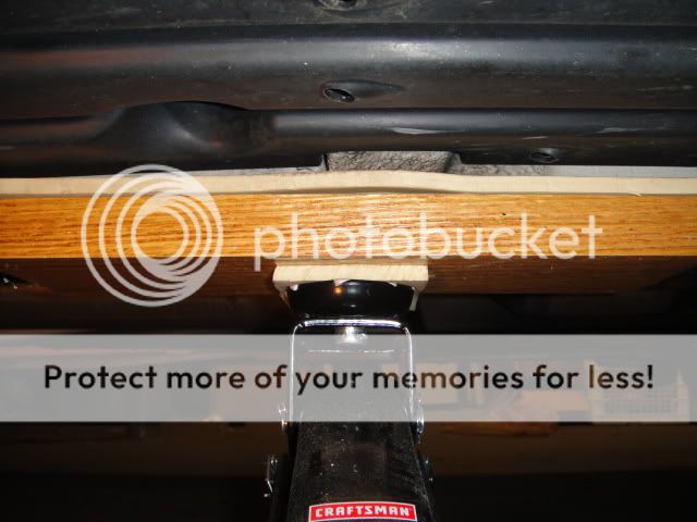

    Here is a good picture to describe what I do:
    except I put the jack a little bit further back than in the picture, under the welded "cross".
    Torque is 76 ft.-lb. Good luck! :)

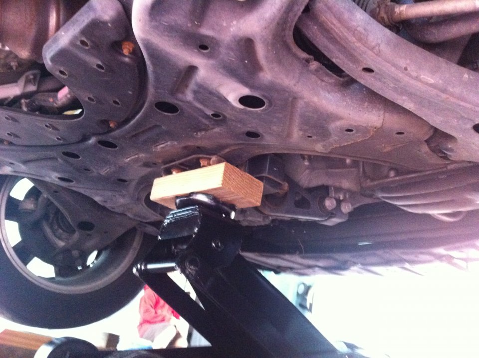

    If that is not required and I am just swapping front to rear and vice-versa, then I will raise up the car in a manner similar to the photo provided by 2009Prius except I will use a 2 ft length of 2x4 lumber in the jack saddle to spread the load, and will place the jack at the outer rail, somewhat forward of center since the car's center of gravity is somewhat forward due to the powertrain weight.

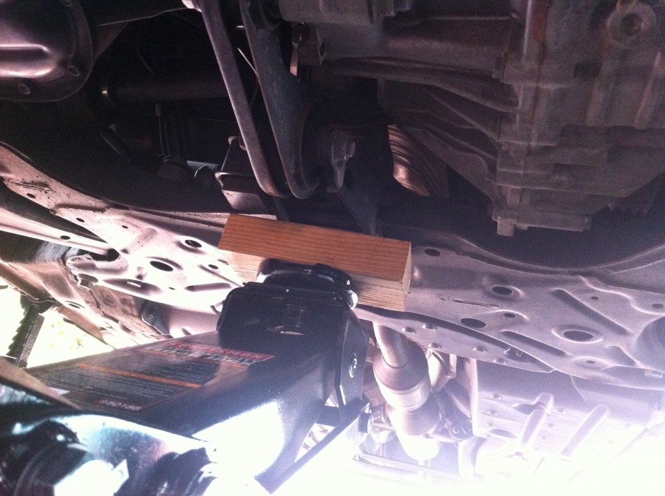

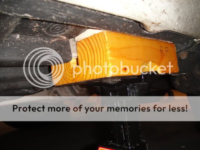

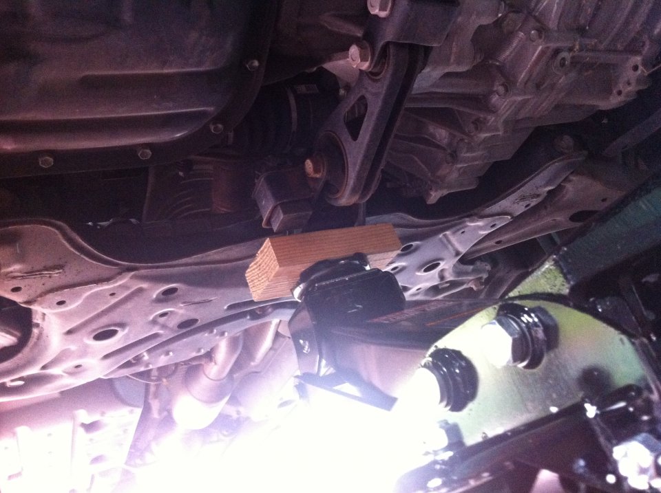

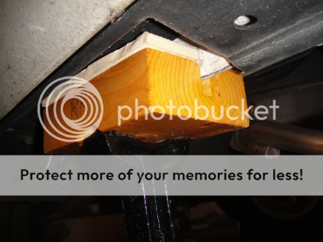

    Here is what I do: (following Patrick's advice)
    Jack under the square rail weld:
    Jack stands under the Toyota jack points:
    And I stick my home made wood ramp under the car for extra safety if I crawl down there:
    blaisep and George Glass like this.

  18. ahmeow
    ahmeow Prius Lover
    Nov 11, 2010
    366
    70
    North CA
    Wow, very nice set of tailor made blocks. Strong and firm,the under frame is vell protected. Zero scratch or hurt. Nice,:p

    Is this the right place to jack for the front of a 2007 Prius?
