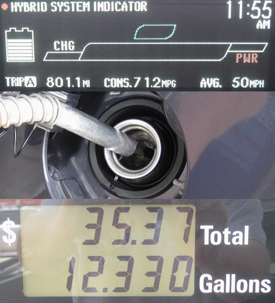

    My check engine light has been coming on and I've been re-tightening the gas cap; sometimes it works and sometimes it doesn't.
    I noticed that when I look at the hole, there is no flap to block the hole. Is there supposed to be a flap that blocks the hole until you insert the gas nozzle when filling gas?

    Inside of the cap blocks the hole!

    Edit: Just saw above posted picture. So I guess you need a new gas cap.

    No flap on Gen III.

    Mine has no flap. It surprised me when I first filled up because all the other fuel injected cars I've ever owned have had a flap. Only owned one carb'd car, have had a few diesels and none of them had a flap; assumed it was a vapour emissions thing. I much prefer it without one, means you can really properly brim it.

    No.
    Check the condition of the O-ring which seals the fuel cap.
