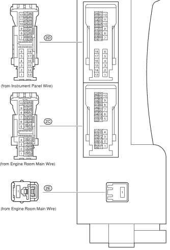

    I got the pin in for the ca1 connector, but I don't see the unlock tab for the 2c connector.
  20. ChapmanF
    28,747
    19,050
    The picture shows "double lock type / housing lance". So, there's a secondary lock, a plastic bar across the whole connector, which you can see having been popped slightly downward (in the picture above). Usually there are a couple of notches along it where your removal tool can fit to pop it. You might have to remove the mating lever handle from the connector to get access to that secondary lock.
    Once that is released, you can see the individual terminal lance is a part of the plastic housing, and you release it by inserting your removal tool from the front. But I'm guessing you don't have a terminal in there to begin with ... ? So you probably only need to deal with the secondary lock.
