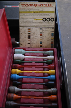

    A torque wrench looks like this
    You tyre shop may use an extension like this
    which is calibrated to tighten your wheels to a specific torque using a pnumatic wrench like this
