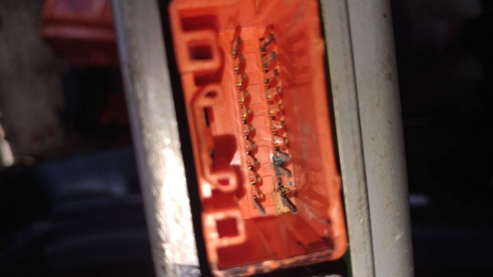

    A couple of images that show some of what is possible, if visible on the outside you may want to look inside the HV battery ECU.
    George W and edthefox5 like this.

    Everyone in that battery should check out the ecu. Here's some photos of mine when I installed my NPB months ago. I was shocked to see how clean the board & connectors were. Its a garaged car so I guess that helps somewhat.
    But in addition to the outside connector sockets look closely around these pins these rot too.
    George W and SFO like this.
