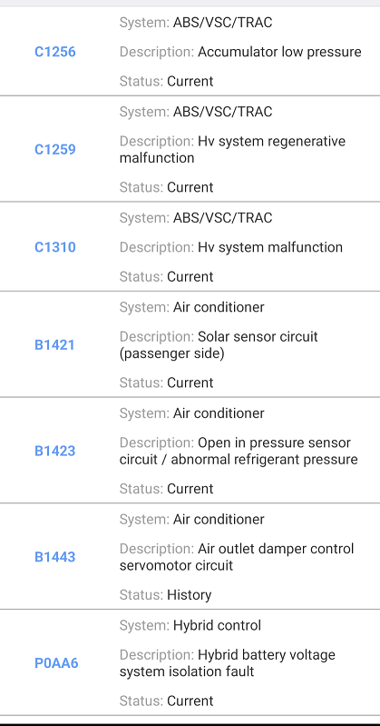

    Quick story: I've had to recharge the AC every year because it starts to blow warm air after 11 months. However, last summer, on the 10th month after the last recharge, the AC blew a burning smell that lasted for a minute and then completely stopped working. I went to a recharge station and they refilled it (they know that hybrids need different recharging vs gas car), but it only lasted less than a week that time. After that, I started getting the red triangle from time to time with the error code P0AA6. I reseted it each time. A few days ago, I was unable to reset that code at all. I decided to buy a more comprehensive diagnostic tool, and here's what I got (C1256, C1259, C1310, B1421, B1423, P0AA6):
    Last time I tried to turn car on the main screen blanked out, and the engine does not turn on. So I can only put the car in "ready mode."

    C1256 is a braking system issue. Maybe back-burner that until the P0AA6 is taken care of and you get the car going to READY reliably again. If the C1256 comes back, you will have a separate braking system issue to deal with.
    C1259 and C1310 are just there because of the P0AA6. They don't add any information of their own.
    B1421 is just a code that is provided so you can tell the solar sensor is working. If strong light isn't shining on it, you have B1421. Nothing to worry about.
    B1423 indicates abnormal refrigerant pressure in the A/C. With the refrigerant leak you've got, no surprise there. The refrigerant is probably gone again.
    B1443 is a problem with the motor in the dash that controls where your heat/A/C air comes out. Relatively minor; back-burner that for the time being. Later on, it will probably bug you if you can't switch where the air comes out, so you can deal with it then.
    P0AA6 is a fault in the safety isolation of the high-voltage system, and this is where you really want a scan tool that can show you the freeze frame and the three-digit INF codes that go with the main code. You want that because the car can be telling you about an isolation fault in these different places:
    If I were in a betting sort of a mood right now, I might put my money on your INF code being 611, and the isolation fault being inside your A/C compressor after it burned up from lack of refrigerant. In which case, there's no sense saying "forget the A/C till you fix the P0AA6", because the A/C is the P0AA6.
    But I don't recommend going by my bet; I recommend using a scan tool and getting your actual INF code. My bet could be wrong, the fault could be in any of the other areas, and so having the actual INF code will save you time and possible wasted effort.

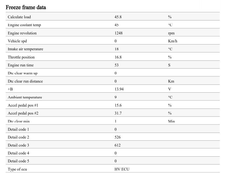

    I was able to read those:
    512
    256
    526
    612
    It means that problem with hybrid battery, right? In this case, do you guys think it is good idea to go with some company (greentecauto, greenbean, etc) to replace hybrid battery completely? Or try to find bad cells? My Prius 2006 has 170k miles on it.

    Well, the whole idea of unplugging the compressor cable was "if you can't get the INF codes, this might tell you if it's the compressor or not."
    But the OP has gotten the INF codes, which was quicker and safer and more informative than fussing with the compressor cable, so now we know the isolation fault is in the battery, and don't need to fuss with the compressor cable.
    Anyway, the most that could have been learned from messing with the cable was "it's 611" or "it's not 611 (so, one of 612, 613, or 614)". But reading the INF code got us right to 612 in one step.
