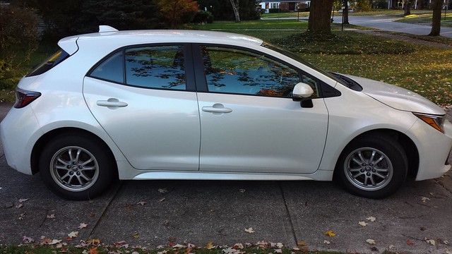

    I had prius wheels on my Corolla.
    I think they looked nice and were probably a bit lighter than the stock 16" wheels. I'll reiterate that the extra sidewall made living in a world of rough pavement much nicer and the Defenders worked in rain much better than the Dunlop Enasaves. The downside is that I kept the wheels and tires which fit no other vehicle I own now. I hoping I hear about someone nearby who needs another set of wheel and tires. I also still have a spare set of wheels and tires from a Golf a sold seven years ago, these things accumulate.
    Now I'm running through the second set acquisition process again. Maybe I'll learn to stop doing this about the time we get flying cars.
