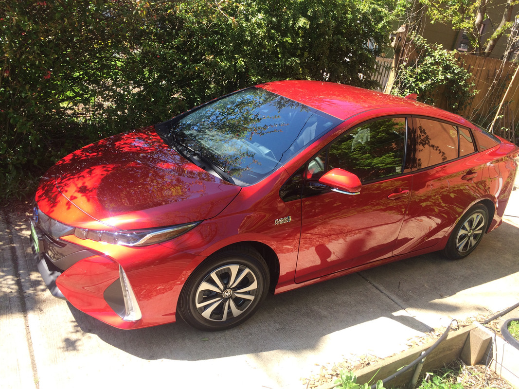

    Totally "chuffed" here. Just got a 2017 plus [​IMG][​IMG]
