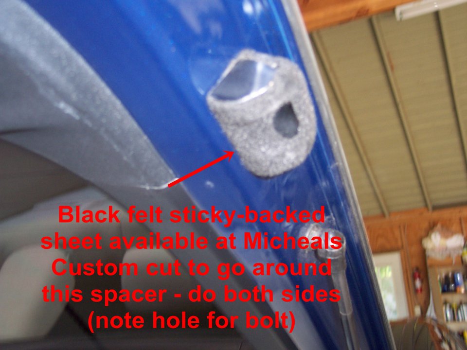

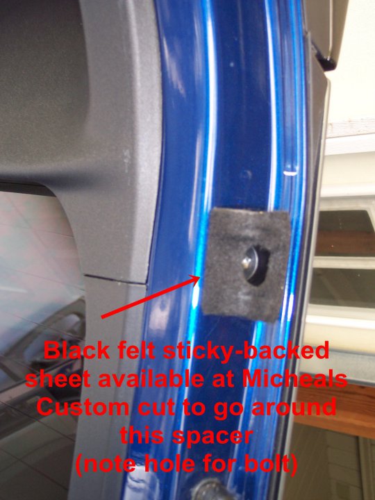

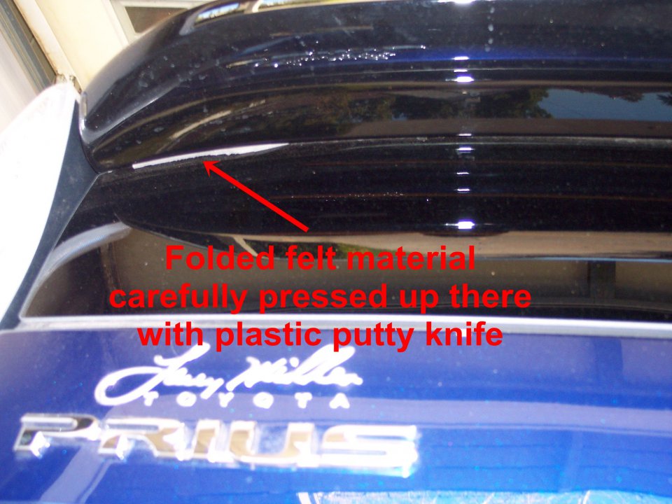

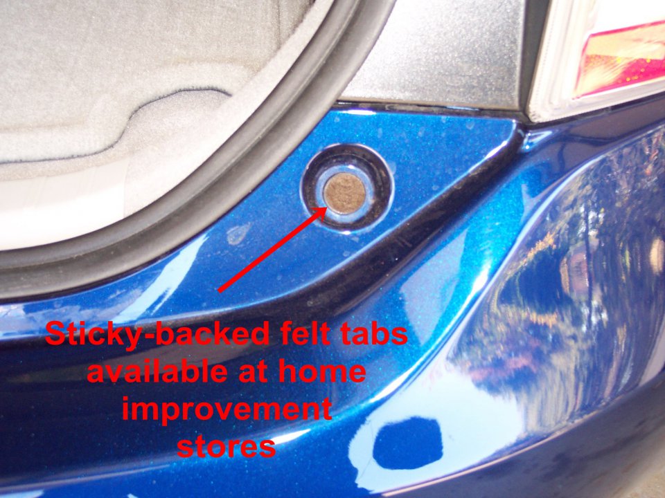

    This solved my hatch rattles:
    #13 phoenixgreg, Feb 26, 2015
