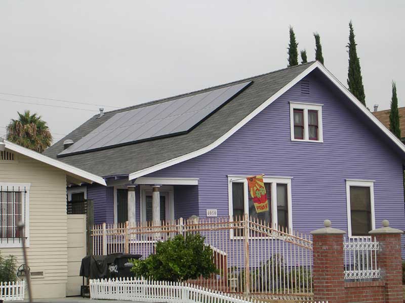

    Well, it looks like it's going to be a while before my system is up and running. The city inspector was here and won't pass the system until I upgrade all of my electrical. I have no idea how many thousands of dollars that's going to cost me. But I reamed the Borrego Solar guys a new one. I specifically asked if my current system could handle the addition of the solar before I even started this project and I was told yes. I said I didn't want to have to upgrade all of my electrical and I was told no problem the existing system could handle it. Now the inspector says it won't. He also says that he should have been called to do an evaluation before work was ever started. Something I told the Borrego Solar people last week. He also said SDG&E should have done the same. Something I told the Borrego Solar people last week. I also told them *that* was the service call I set up for yesterday that the doofus idiotic moron project manager canceled. "I told you so" doesn't do me any good but I am sure going to use it profusely. I'll be sharing my concerns about the project manager's abiltiy to do his job and whether he should continue to enjoy his current employment status with the owner of Borrego Solar on Monday. I doubt anything is going to come of it because I'm pretty sure the doofus is the boss' son. I did repeat what I said last week to the installers to the Borrego Solar guy (and the inspector) today that the doofus project manager Josh should have hauled his a$$ to my house and looked it over and set up all of the evaluation inspections two weeks before any work was ever done. Then set up all of the inspections and service calls in plenty of time. That way they'd have an organized plan of installation instead of this long, drawn out install by the seat of our pants thing.
    Well, they've got $23,000 worth of solar on my roof and only have $1,000 of my money in their pocket. If they want to get paid, they better get my system up and running. If they're smart, they'll offer to upgrade my system for free or at an extreme discount just to make up for all of the careless planning, delays and the general incompetance of their moron project manager.
    In the mean time I've got all these panels on my roof looking all shiney and new and doing....nothing.
    I think I'll go demolish my closet now.

    <div class='quotetop'>QUOTE(Godiva @ Aug 10 2007, 04:23 PM) [snapback]493749[/snapback]</div>
    Ouch - that sucks. I think your plan is a good one - withhold payment until they get your electrical system upgraded. Know any good attorneys?

    Godiva,
    I have heard of tankless water heaters that are weatherproof and designed to be mounted OUTSIDE of the house. These are for temperate climates, but I think San Diego certainly qualifies. This would save you closet space.
    Sorry to hear about the inspection. I checked out your web page and your panel is tiny by modern standards. But ironically, the grid-tie PV system would reduce the need for a larger service drop...
    Hope it ends well.

    <div class='quotetop'>QUOTE(Godiva @ Aug 10 2007, 11:45 AM) [snapback]493636[/snapback]</div>
    Thanks :) I'm happy now, but I am calling chopper 5 now to take an aerial view :D
    Sorry about the inspectors answer, it is probably in your best intrest to upgrade to at least a 100 amp service, but whiile your doing it a 200 amp service may not be that much more.
    60 amp service is a thing of the past. Just like you said, go after the doofus who should have known better before selling you their pv's. and getting a pre inspection done.

    According to the inspector, even 100 amp service isn't enough. I need 125. And I agree. If I'm going to upgrade, why upgrade to only exactly what I currently need? Better to anticipate future needs. Who knew 50 years ago we'd have TVs, VCRs, DVD players, digital clocks, microwaves and computers that would push our electrical needs beyond the standard 60. Apparently my circuit breaker box can handle more than the actual power coming in. Is the line from the street, down to the meter and from the meter to the box that the inspector says needs replacing. He says SDG&E might upgrade the line from the street for free because it is so old. Then he talked about having to do some carpentry to upgrade where it attaches to the house. More money and more ugly. Then he talked about the breake box moving from where it is in a closet to outside the house where the meter is. More and more ugly. And inconvenient. So I can come outside in the rair or dark when I want to turn off a breaker and work on something.
    I've got nightmares of whoever does this not only doing that but saying they can't move the existing wiring to the new location so I have to have the entire house rewired. I've got the old black cloth covered wire instead of romex. Well....I've got insulation and boards in the attic and lots of boxes stored up there. I can see him going up there and saying...you'll have to remove all of these boxes, then take up all of the boards and remove the insulation so I can drill through the studs and run new wiring.
    THIS IS WHAT I WAS TRYING TO AVOID.
    Well, we'll see what solution Borrego Solar comes up with. I consider this their problem as *I* asked over and over in an attempt to avoid this very problem.
    In the meantime, the tankless water heater is on hold.
    And did I mention that I go back to school in two weeks? So if it isn't done.....it's going to wait until at least Thanksgiving, Christmas, Easter or next summer. I can't just take days off from school for this. And I told them all of this up front in JULY.

    ohhhh no! sounds like you did your part to make sure everything was taken care of and the solar company dropped the ball big time. i hope they do something for you for all the inconvenience and frustration you're going through.

    As much as I want to get off of the grid and use a PV and/or wind energy alternative it's things like this that make me hesitant. The cost of the PVs alone is so high, if you start throwing in several thousand in additional wiring and such it can become a truely monumental expense.
    That said, we plan to build a new home in a few years and have every intention of making it solar and energy efficient, but I think incorporating everything into the initial build will be simpler and probably less expensive than an 'add-on' system.

    It is. And I think a lot of solar companies are used to doing new builds. BUT....they should also be knowledgable on retro fitting older homes. It's their jobs as professionals to know the codes, evaluate the systems and create a plan on how to do an install before work ever starts. And if there is anything that the homeowner needs to know...like....gee you don't have enough power coming in and your circuit breaker board isn't big enough and is in the wrong place....the homeowner needs to know before work starts. One of the workmen who was planning to put in two more grounding rods asked me...is this city or county. I told him...I'm in the city. You don't even know where my house is? The codes are different for city and county. You need to know what the city codes are.
    The inspector said more than once; the system isn't up to code. It's grandfathered in and as long as you don't touch it you're fine. The minute you touch it, you have to bring the entire thing up to code. They should have known this. It was their job to know this.
    I'm waiting until Monday to see what they intend to do. I'm not calling them. I left a message with my sales rep. I'll let them stew and contact me. (After all, I still have $22,000 that they want.) I'm hoping they'll opt to do the electrical either gratis or for just the cost of materials. They can consider it a lesson learned and they'll know better the next time.

    There is nothing wrong with the work the installers did. Very neat. The Inspector had no problem with it and said they are top notch.
    The problem I had was with their "project manager" Josh. He never saw my property. No evaluation of the existing electrical system was done. Neither SDG&E nor the City was called to inspect before the work was done. Had that happened I would have known about all of this before any work was done. AND Josh CANCELED a service call from SDG&E that *I* had set up that would have identified some of these problems.
    I think Josh is their weak link. That's where everything failed.
