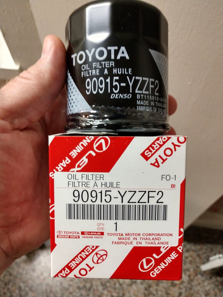

    I'm baaaaaaccckkkk. I just purchased a 2019 Prius XLE, light green, black interior. I am wondering if there's anyone here with a 2019 Prius that would happen to know what the part number is for the oil filter? I would appreciate the help.

    Here you go. Be careful and don't let anyone sell you the cartridge type. Toyota is shifting most of their cartridge filter engines back to the spin-ons. I actually tried to get the cartridge for my new 2018 and the parts guy at the dealer had to set me straight (after I tried to set him straight...). As of 2018, the Prius is spin-on, like this:

    Just make sure you have your VIN when you go to the dealer, not just year.

    EKPolk, I thank you for the information regarding the part number information for the oil filter on my 19 Prius.
